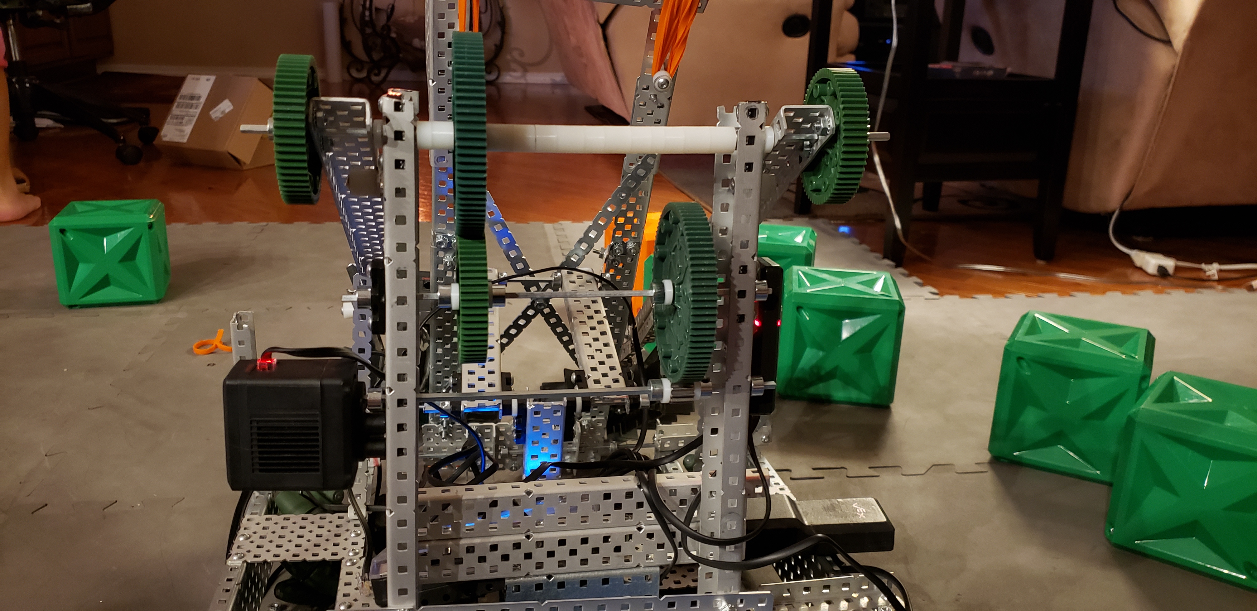

Issues with arm raising
Well quite honestly that’s still a problem. You want the robot to be as rigid as possible, with no angling unless required by design. One thing I would recommend which may be too late is don’t use those aluminum/steel plates as a chassis base. The problem with them are yes they are good Lego like plates, but for robotics, they are horrible for mounting subsystems and bend relatively easily compared to C-channel. If possible, I would redo the entire chassis, using mostly C-channel with C-channel supports rather than plates. If you use nylocks, 2 to 3 c-channels as bracing should be sufficient. This would help drop overall weight and allow you to have mounting spots for your bot’s lift and such. Another piece of advice, you don’t necessarily have to have a chassis brace near your lift. I see the bulk of your chassis bracing also braces the lift but since the chassis bracing is kinda weak and the plates don’t allow for mounting spots, a lot of your tilting and breaking and maligning problems are occurring here.

I just do not know where to secure the arms at a point where it’s not too wide or top narrow to intake cubes

To keep the two uprights parallel to each other and perpendicular to the base, you will probably want to add two bars spanning it in an x formation.
YES, you REALLY NEED to REDESIGN. You NEVER make your towers for you arm tilted. Always add support to the lift arms.
Whoah whoah, hang on there, no need for that much aggressiveness. Use italics or bold for emphasis instead of caps.
Also, a redesign isn’t absolutely necessary, all the OP(original poster I think) has to do is to straighten it out and he/she should be fine.

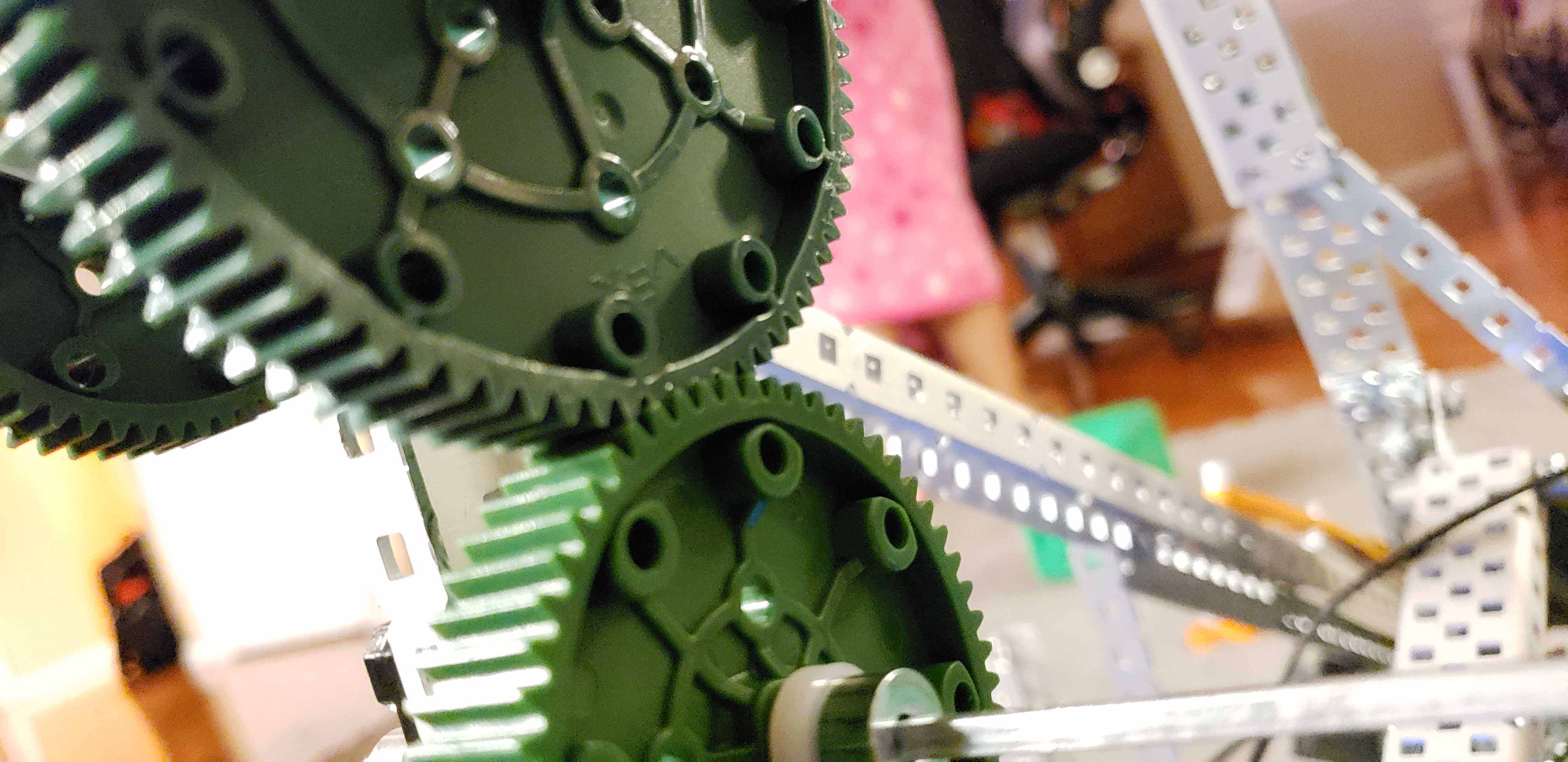

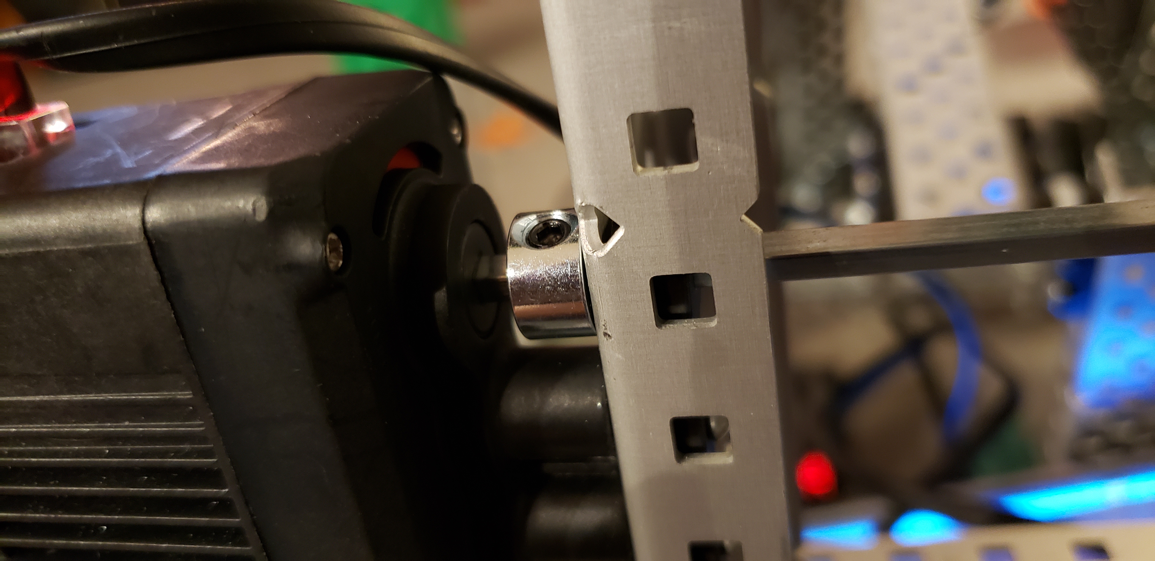

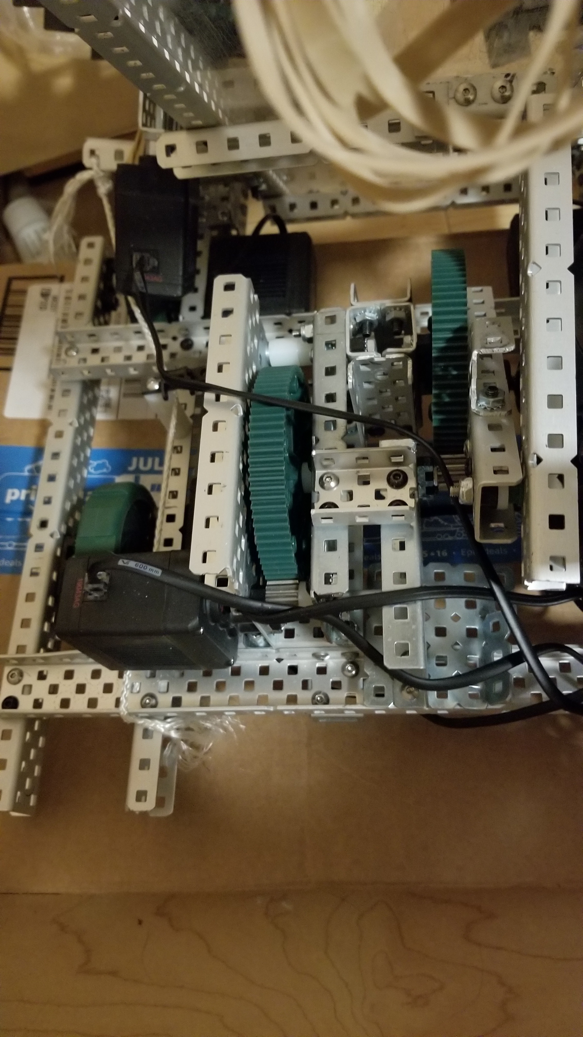

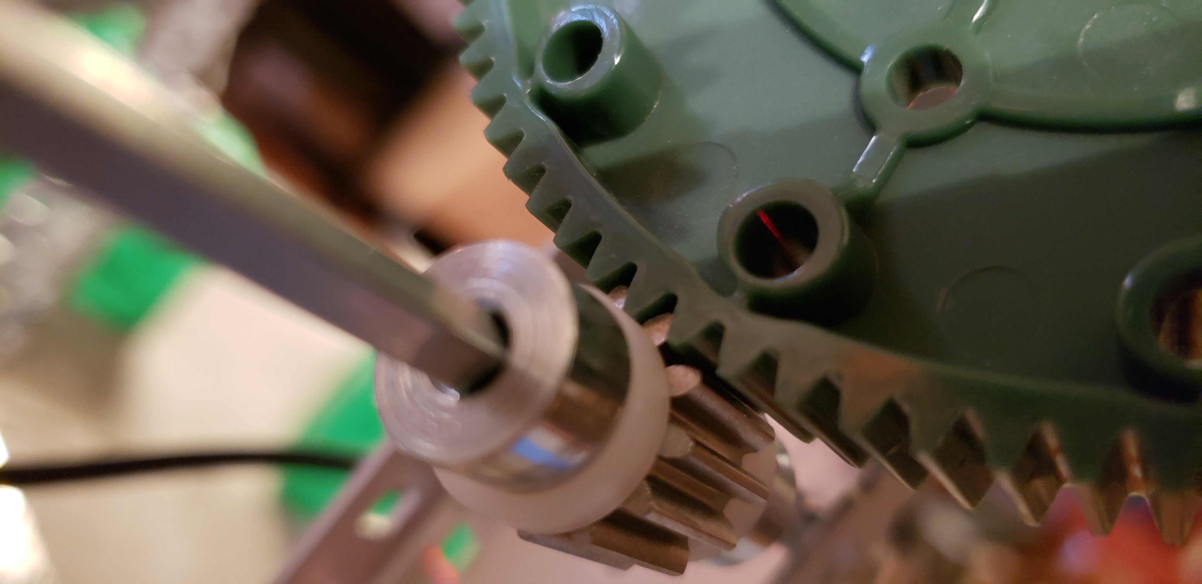

Ok, so issue. I have this mechanism for gearing, and after a second, it strips somewhere. I dont know why, but it does. How do I prevent this?20190918_194751 20190918_194730 20190918_194721 20190918_194712
so you’ve definitely made good progress. the reason your gears are still slipping is that the shafts they are on are flexing. to solve this, you need to add 2 more towers, so that the gear ratio is sandwiched in between them. Also I notice you’re using a compound gear ratio, which really shouldn’t be necessary tbh.
@Xenon27 I’m confused what you mean by compound gear ratio, and I held the shafts together with my hands and it performed fine. How would I transfer this to my robot?
so you have a 1:7 ratio, and you also have a 5:7 ratio after that before it gets to your arm, which is a compound ratio. the added support towers accomplishes this effect, basically you need support immediately on either side of your gears
Something like this
20190911_224903
Notice the outermost c channel on the right. That is to stop the gears from skipping. Now of course it’s not the same design, but it should give you an idea.

You could but with the gears you might need some more shaft collars.

I have nylon spacers plus collars locking them into place. The vertical problem is the issue.
