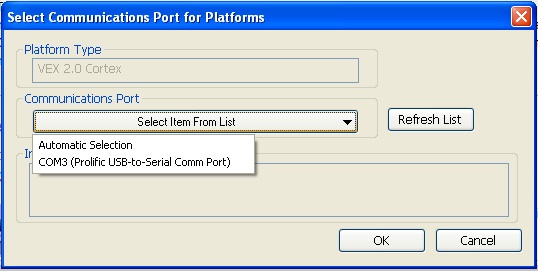

Next, start up ROBOTC and check that it can see the com port also, goto the “select communications” dialog and check that the port is in the pulldown list. Leave the setting automatic but just check that the port is available.

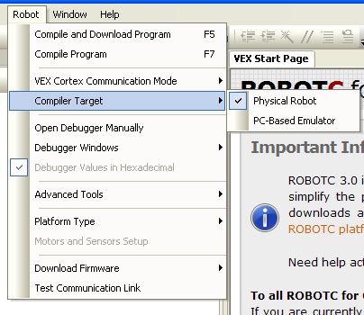

Next check that you have the “physical robot” selected, that one always gets me.
[ATTACH]5971[/ATTACH]
If all this is good then try to do a software inspection using the Robot->advanced tools menu and let us know what happens.
