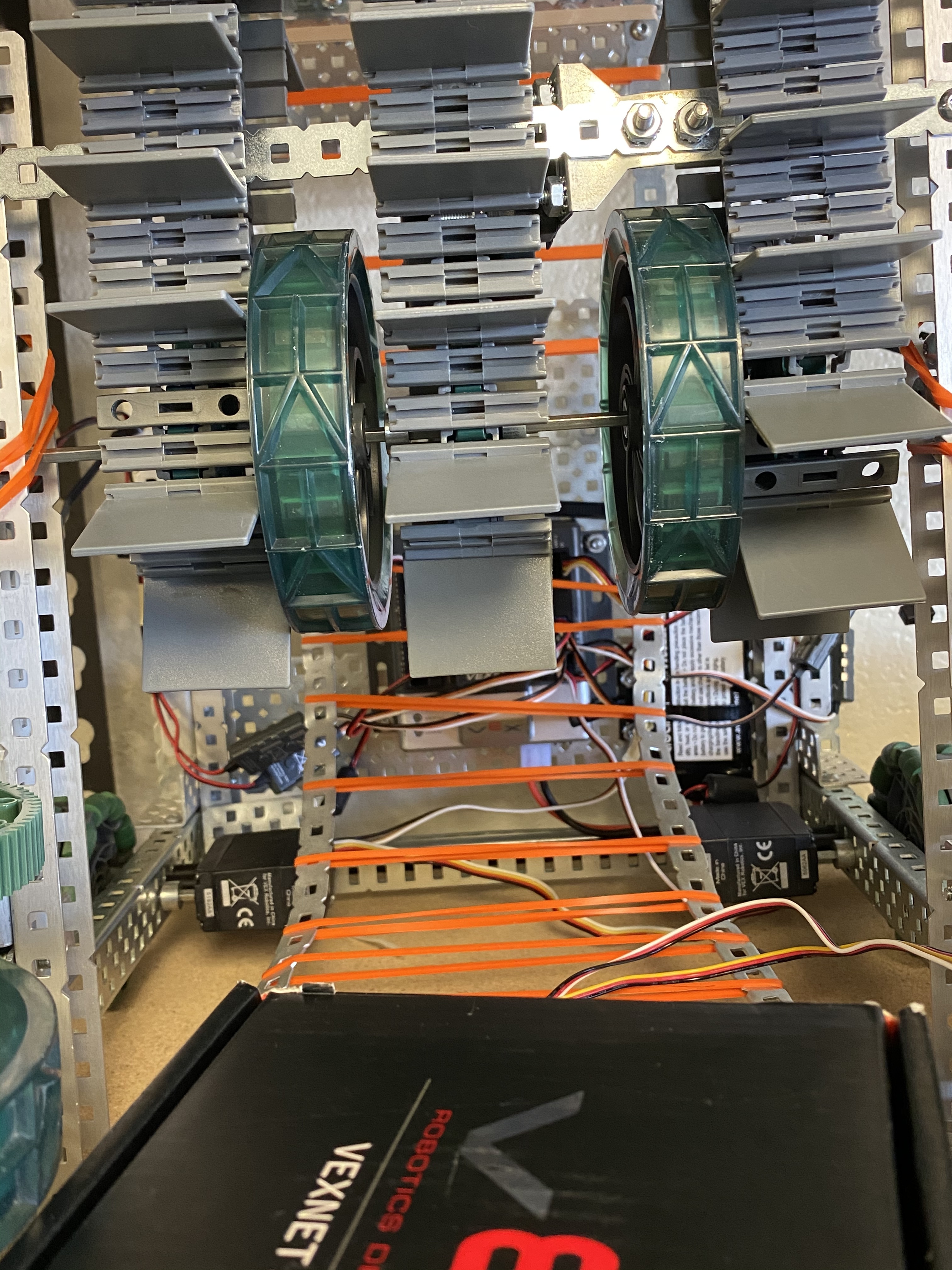

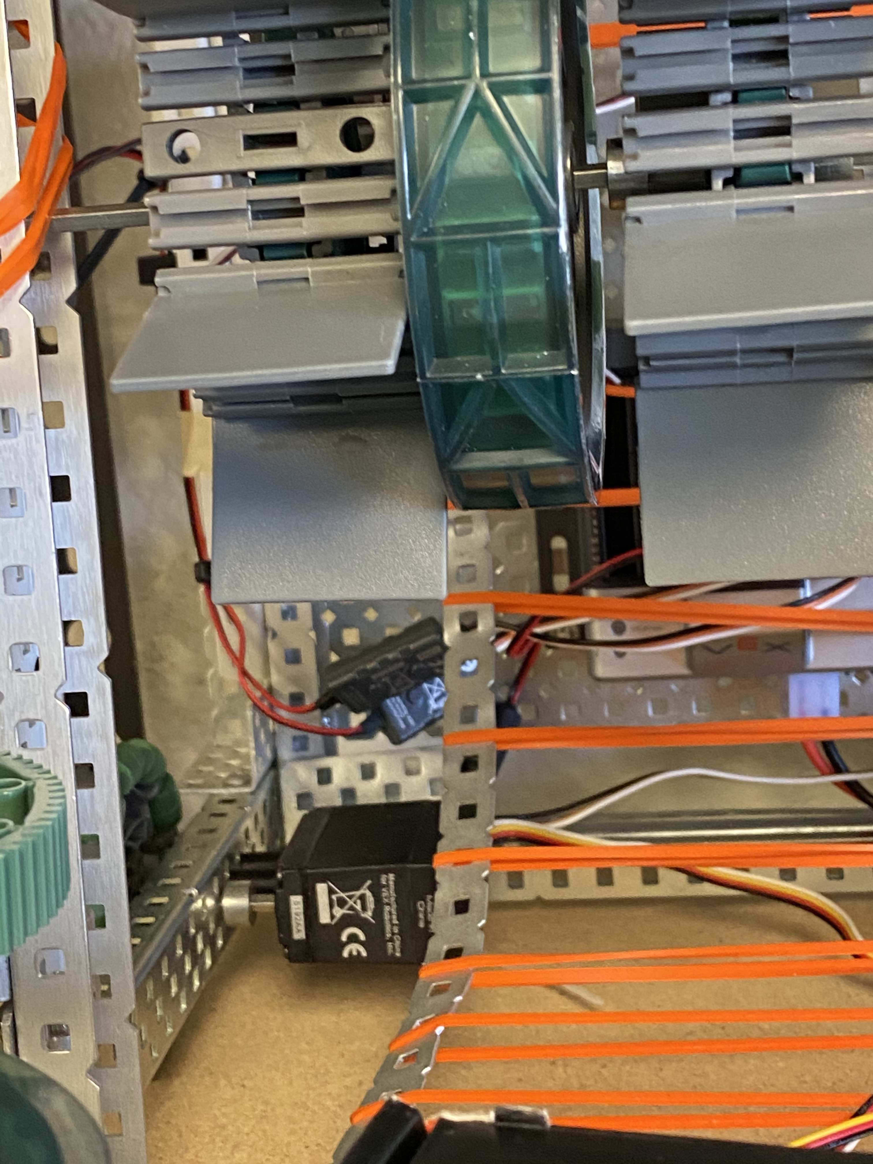

Pictures of your setup will help. People can always find the problem faster this way.
These are the only pictures I currently have

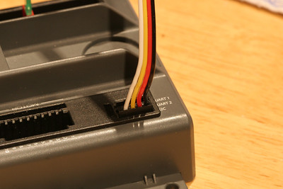

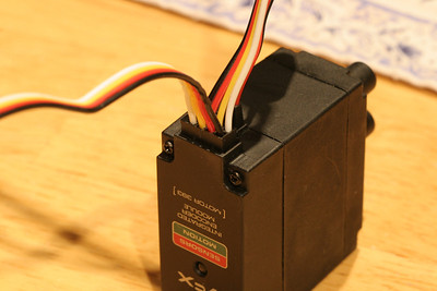

make sure the cables are fully seated, they can be difficult to push into the encoders sometimes.
This is how they should look.
and the connector is in the correct place on the cortex.
