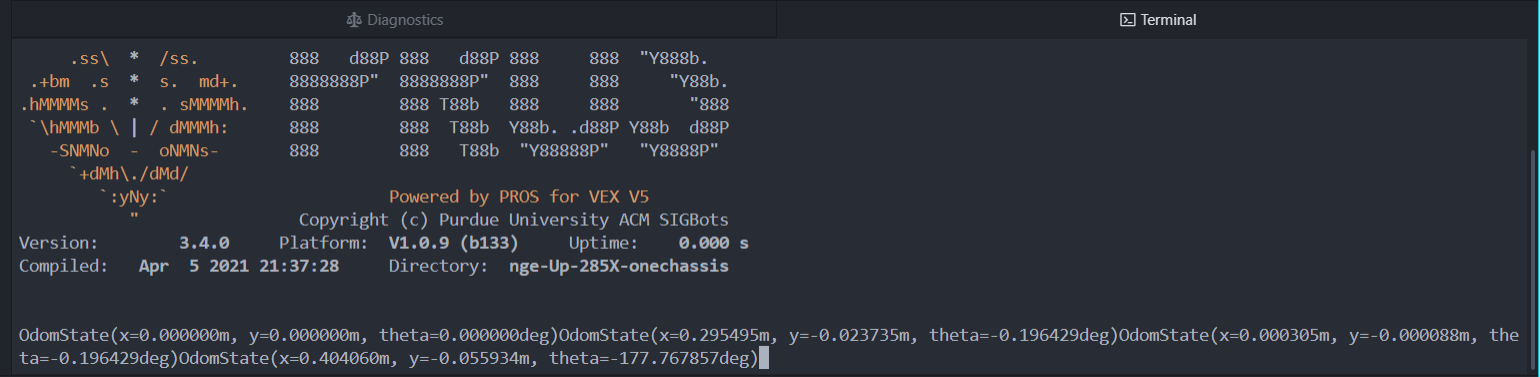

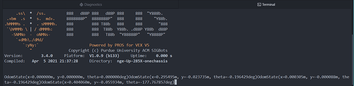

What happens if you print out the results of odomchas->getState() before and after each of the driveToPoint calls?
encodervalues2
This is what I’m getting (sorry for the bad formatting lol). It seems like the 2nd setState isn’t working perfectly (not setting the states to exactly 0).
I put the getState() statement right before and after each driveToPoint statement

Here is where I have placed each of the output statements. I placed one before/after the first driveToPoint, and one before/after the second driveToPoint. The outputs in the screenshot above are in order according to the code. The first getState() gave us all 0’s, which is expected since I have a setState(0,0,0) right above that. The second get state gives us the position of the robot after I instructed it to move forward 1 foot, giving us 0.29 m which is roughly a foot. The third get state gives us values very close to 0, but not exactly 0 , which maybe a problem since I setState to all 0’s right above it. The last getState is after the driveToPoint (where the bot goes haywire and turns 90 degrees and backs up), giving us erroneous values.
The odomstates would be read like this:
Odomstate(x=0, y=0, theta=0),
//drive to point () #1
Odomstate(x-0.29, y=-0.023, theta = -0.19)
Odomstate(x=0.000305, y=-0.0000088m, theta = -0.19642 deg)
//drive to point() #2
Odomstate(x=0.404060, y=-0.055934m, theta = -177.767857 deg)
