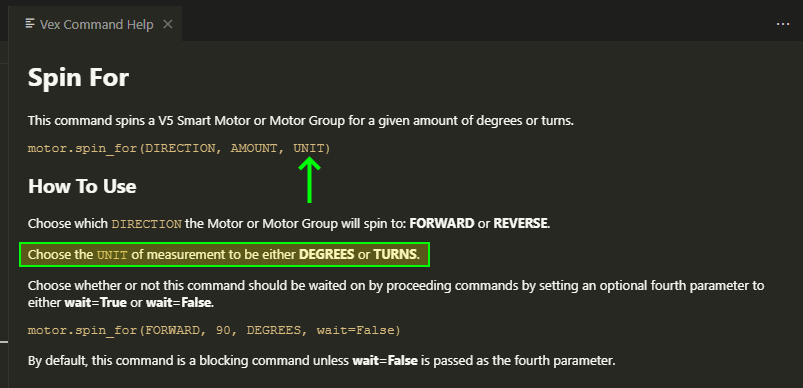

First of all, you have to pipe the distance argument from sideL into inches_degrees, then from that function into the spin_for member function.
Here is the Vex Command Help for spin_for
The third argument of spin_for is a unit of measuring how far the motor should spin.
The second argument of spin_for is how many of those units the motor will spin for.
Because we can’t make our own units for spin for we have to convert a unit we can’t use to a unit we can use; hence, the inches_degrees function you made.
like this:

Second of all, the reason inches_degrees is coming up with errors is because spin_for is expecting you to give it either DEGREES or INCHES (see the Vex Command Help), but you gave it a function instead.
