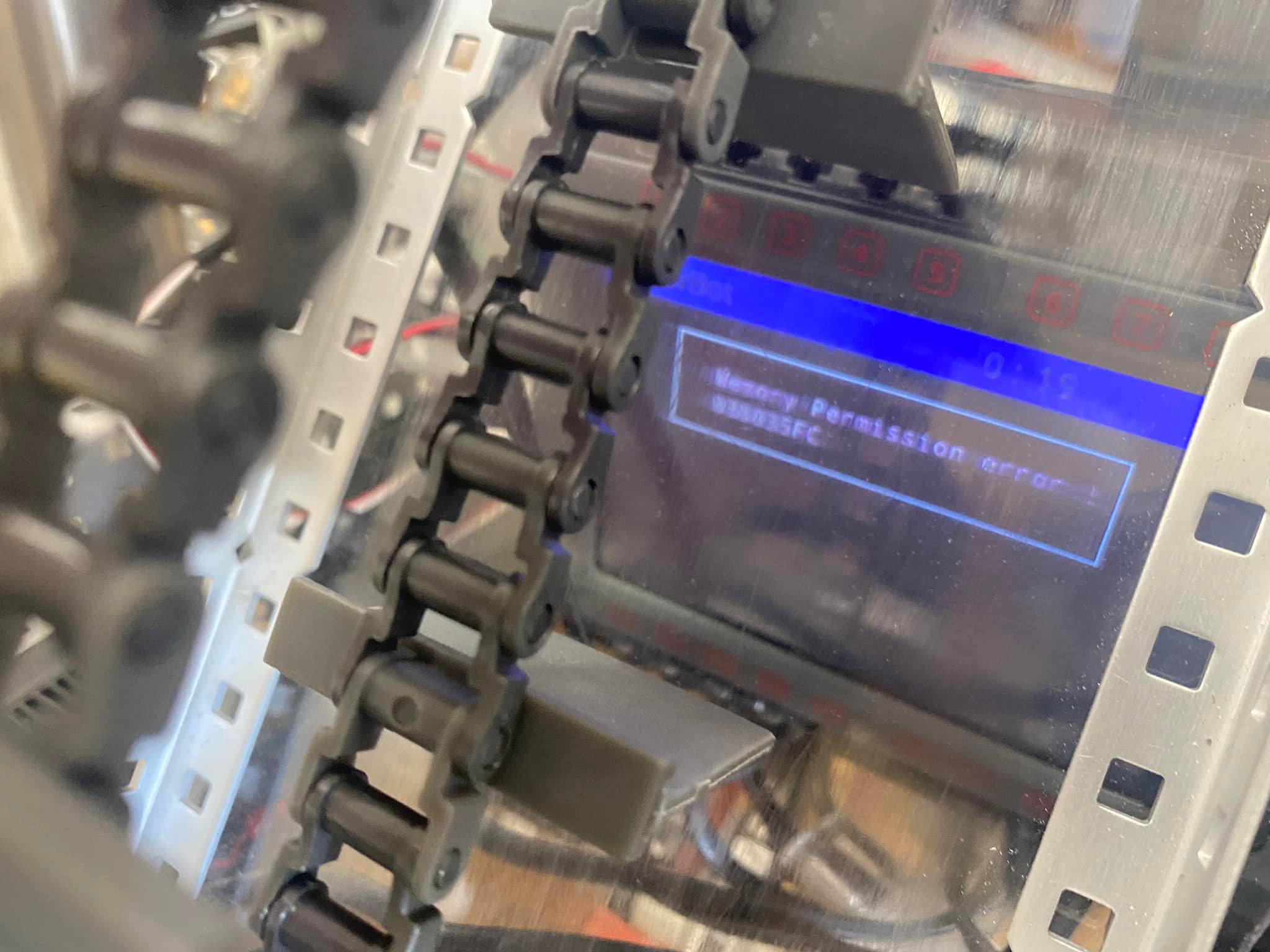

Anyone using motor_groups and written smart drive code? Did anyone notice that the 2.0.5 vex code pro is now giving an error? I have a couple teams that wrote out the smart drives instead of using the GUI for more useability, and it worked at all our tournaments all season but since the upgrade to the new code program they only get this screen
As soon as we remove the motor groups the error goes away, but our auton is useless

The issue with the code is primarily caused by use of the inertial sensor instance before it has been constructed. The reason it is broken in VEXcode 2.0.5 is because of a change I made to the smartdrive constructor, it now calls a class member function of the inertial instance, this fails if the inertial instance does not exist. (and I will look for a workaround for this in a future SDK release, but no promises)

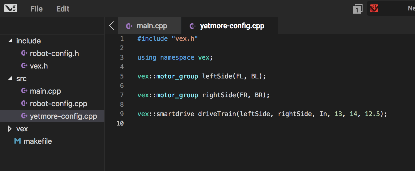

  1. use another file and rely on the gcc linker behavior of alphabetical order processing. For example, I created another file called yetmore-config.cpp and moved the drivetrain and motor groups there.
then in main.cpp or vex.h add a declaration for the drivetrain so as to be able to access it.
extern vex::smartdrive driveTrain;
