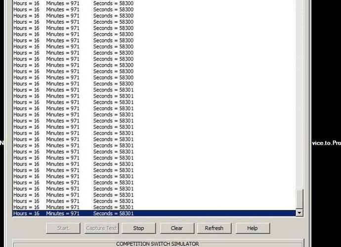

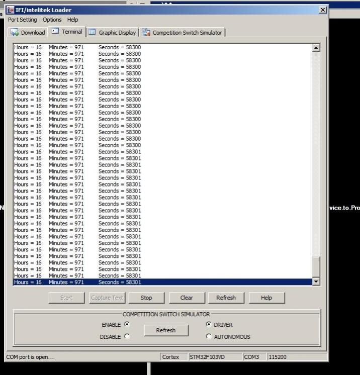

As of now we have run our own code overnight 12hrs one night and 16hrs other. We have run Paul’s code for 4 hours and not had any drop out issues.
We have created a worst case program we have started running, two quad encoders, with two motors, and the ultrasonic, running the LCD Module showing the both encoder counts, and the Graphic Display showing the Ultrasonic, Encoder Counts, and the time running.
Last Nights Test
https://vexforum.com/attachment.php?attachmentid=3448&stc=1&d=1290109236

After more testing we found sending large amounts of Terminal data or Graphic Display may cause VexNet to drop out. So, for the mean time we would suggest that you turn those off during a competition. I suggested to Paul to use a digital input and a jumper to turn them on and off.
