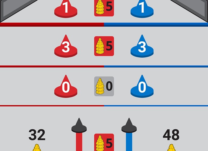

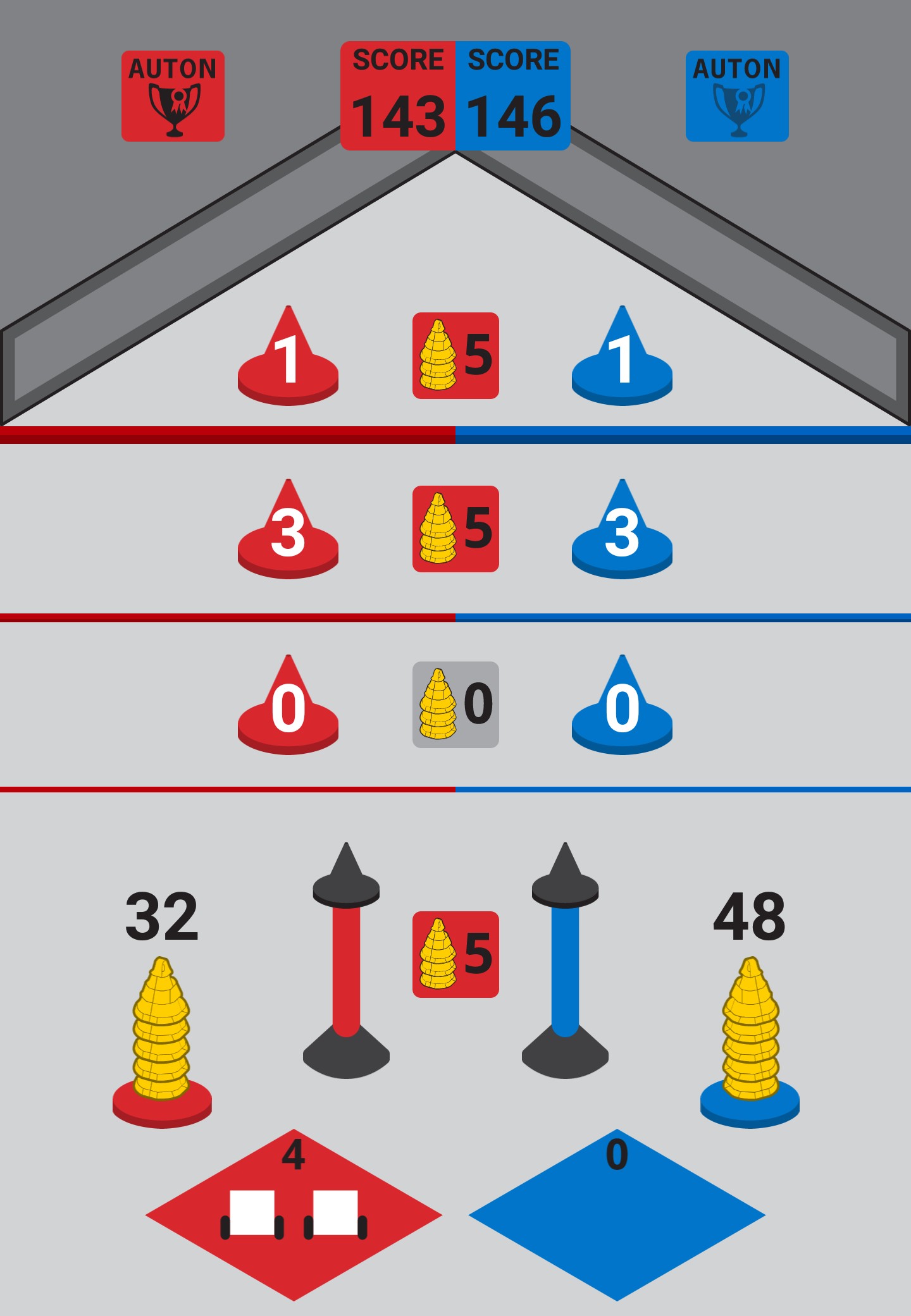

Actual scoring of match:
Opponents:
  • 1 20 point zone
  • 3 10 point zone
  • Highest stacks in 20, 10, and standing goal
  • Auton bonus
  • 2 parked robots
  • 33 cones
  • Total Score: 145
    You:
  • 1 20 point zone
  • 3 10 point zone
  • 2 parked robots
  • 47 cones
  • Total Score: 148
Woops; I’m too used to the scoring of Starstruck…
Minimum score is 146. See attachment (blue represents guaranteed victory). VRC Hub still has some bugs; see attachment.
