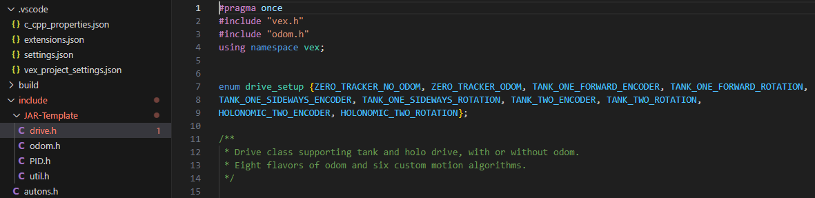

I have started the path to learning this so I can teach my students. Struggling a little at this point. I have installed VS and the Vex VS extension, started a new project and saved it and then copied in the src and include folders into the project that was created (afore mentioned import issue work around).
I am not confident that all the headers are talking to each other or maybe the libraries aren’t loaded, but I get a lot of syntax errors because it seems the classes aren’t recogized. Please see the below picture and tell me if this is what should be expected at this point.
They are just intellisense errors because (I assume) drive.h doesn’t include vex.h, but it really doesn’t matter if the project builds. This sort of thing happens often in development when headers need to be included in a source file in a specific order.
drive.h actually does include vex.h, but I think the squiggles actually come from lack of namespace, because changing motor_group to vex::motor_group for example, removes squiggles on vscode.
I do have a question, @jpearman, design-wise, would it be wise to add using namespace vex to the top of these files, manually add vex:: to each class, or is it really not such a big deal?
I may just work through these for my learning’s sake, but would certainly love guidance along the way as I learn.
I added include odom and namespace vex on the top of the drive.h file and knocked all the intellisense errors down to just 1.
The only thing left is “task” inside of vex isn’t recognized
It’s just intellisense being dumb.
In whatever version of VSCode and Intellisense I have installed, the squiggles don’t show for motor, motor_group etc. but do for vex::task. Depending what other files I open, it finally figures it out and they go away.
It’s generally not popular if a header file uses “using namespace xxx” as everything in that namespace gets pulled in, better to use
using vex::motor
etc.
However, it probably doesn’t matter with these V5 projects.
Already robot-config.h has “using namespace vex” which is included in vex.h, there’s a lot of circular including going on, vex.h includes drive.h which includes vex.h, obviously #pragma once should deal with that but perhaps it confuses intellisense, idk.
project builds, that’s all that really matter.
