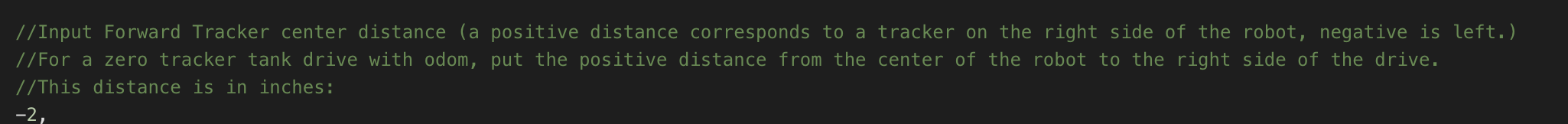

I was looking at the zero tracker odom setup in JAR template. Looking at this screenshot,
Would you set the distance based on the actual drive, the motor, or a wheel?
That’s just the distance from the center of the robot to your tracker (which in this case is the drive wheels on the right side of your robot).
In practice it’s the width of your drive from center of wheel to center of wheel divided by 2.
Looking through the backend code some more, I realized that it’s based on the drivetrain side in general since it uses motor groups.
However, this did give me another, entirely different question: what is the point of the heading PID?
Heading PID keeps the robot facing in the proper direction as it drives.
The drive function uses two PIDs concurrently: heading and drive. It adds them together to keep the robot going straight.
ohhh, that makes sense. Thank you!
