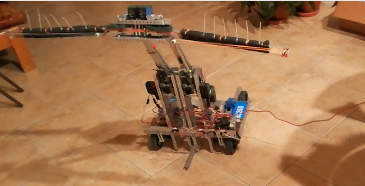

Yes its another questing involving jittering motors. I have a 6 motor drive with some high speed gearing. (1:1.5 with high speed motors, so essentially turbo gearing) It had been working quite well until yesterday when I finished the final wiring on my robot.
When I drive it, after about 15-20 seconds the motors start jittering as though they had stalled or had conflicting commands, the motors aren’t even slightly over-worked, as this robot can drive for 10 minutes without stalling (actually I haven’t stalled it yet) and it can push cubes under the fence. I have double checked the code - although I haven’t changed that since it was working - and some of the wiring, but I haven’t come up with anything yet.
Two drive motors on each side are wired together with Y cables, the other two are single wires. They are then wired to the power-expander and from there to the cortex. Prior to these problems they were wired directly to the cortex along with everything else. They are also on separate internal fuses, Ports 2 and 3 than 8 and 9.

Here’s a picture, although I’m not sure why a picture would be usefull, but have a picture anyway.
(Please ignore the broken line tracking sensors)

So all six motors on one power expander? That places them all on one 4A circuit, the fact they are split on the cortex now doesn’t matter. What does the led on the power expander do? Does it go yellow or red at all?

I didn’t think about the single circuit in the power-expander, I expect that’s the problem. I will try moving half of the wires so that they plug directly into the cortex.

Thanks everyone, with your help I got the problem sorted out. It appears I was overloading the power-expander. My solution was to simply move two of the drive wires to the cortex, replacing one of them with the claw motor. It now works just as well as it did before, so well in fact that I thought I could try and make it a bit faster, just for fun. Here’s the result:

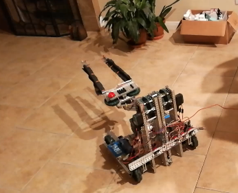

My robot had a tendency to flip so I added pop-out anti-tip which works but when the robot dumps the front 2 wheels come off the ground causing stress on the back motors, should I go with this and tell my driver no not abuse the drive when dumping. What do you think?

What part of the dump do the anti-tip bars touch the ground?
You should be OK to run this. Test it to make sure though.
