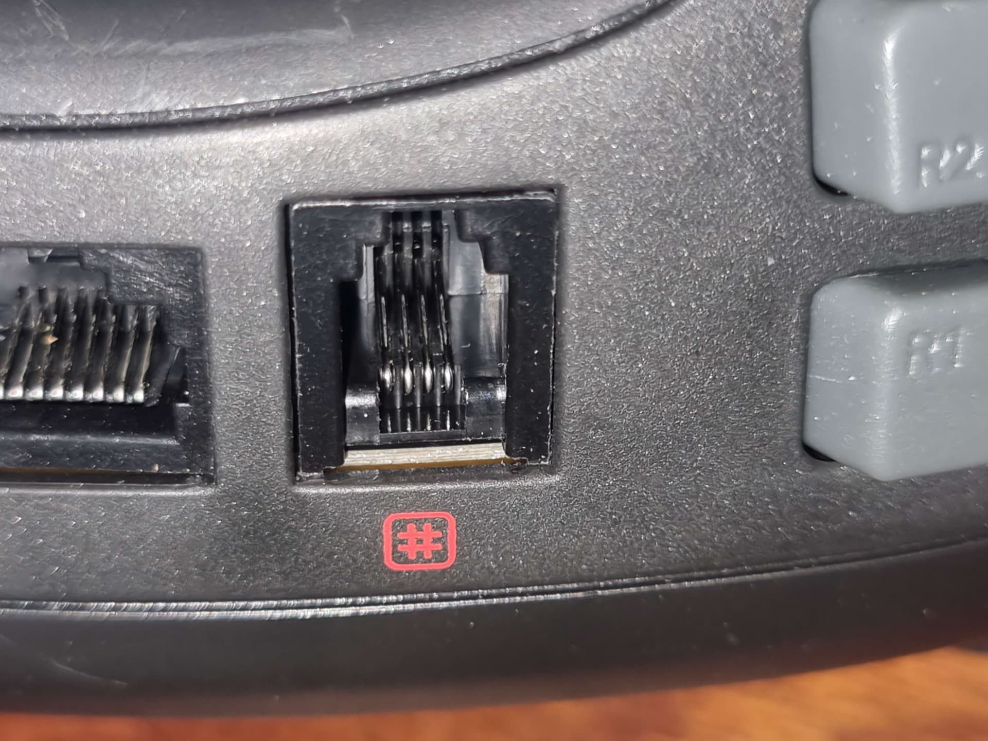

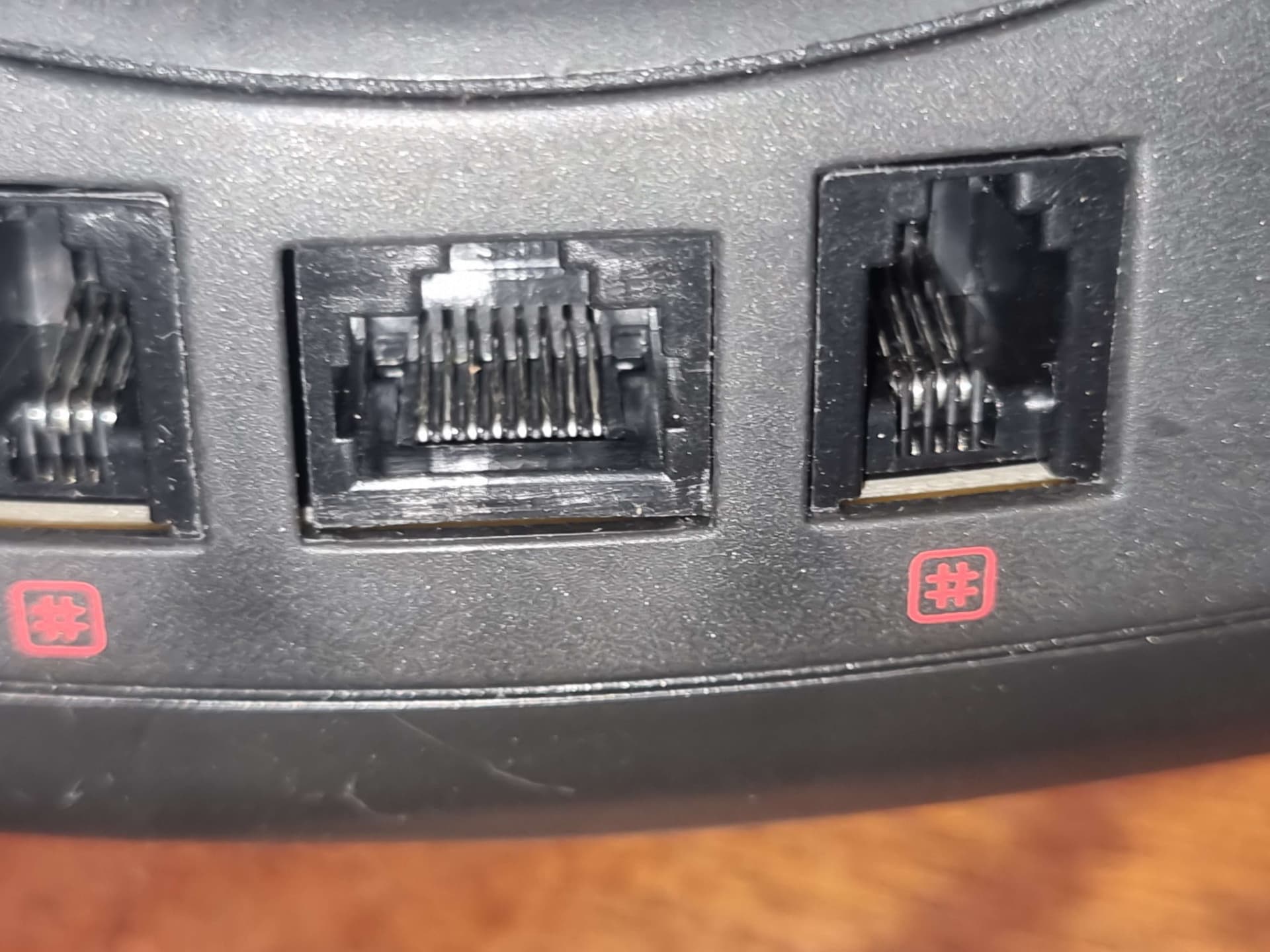

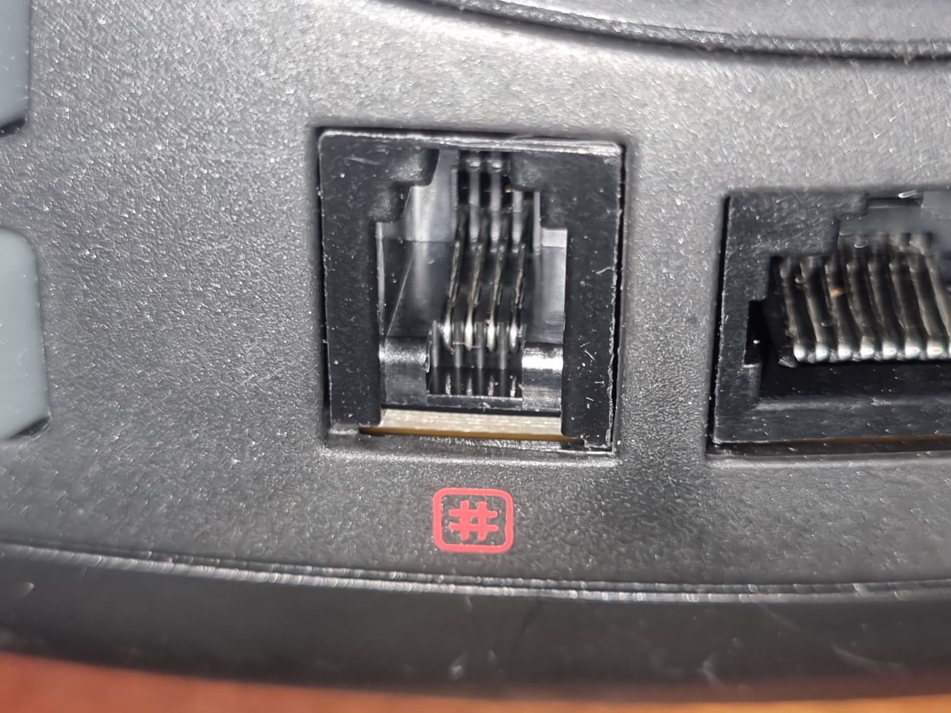

Having just sat down and tested myself, it appears the radio connectivity is functioning.
The issue appears to be the controller is permanently locked into autonomous. Looking in the field control port and smart ports, no pins appear to be bent to my view (images attached)

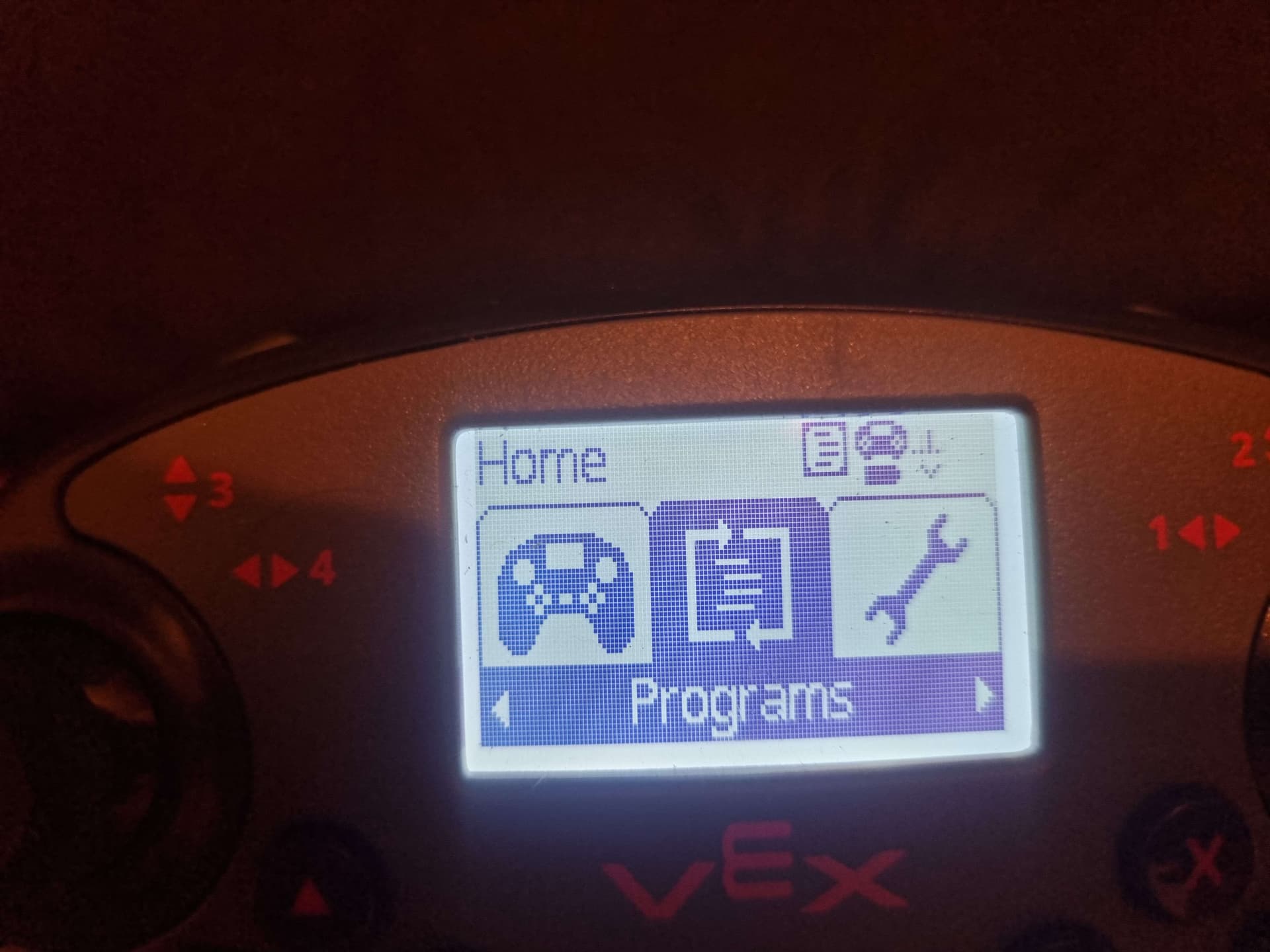

When utilising an old manual field controller, the robot enters the disabled state correctly; however, driver control results in autonomous activating. The autonomous program symbol is permanently visible on the screen, as pictured. I will try continuity testing the field control port to validate if the autonomous pin is shorted. Still, my multimeter probes are a bit unwieldy, and I do not have a cut ethernet cable right now.

Continuing my diagnosis, the joystick, when set to Bluetooth, displays a red screen stating it cannot use Bluetooth - which, with my joystick on the same brain, runs fine on Bluetooth.
The radio screen on the brain shows competition mode when no competition switch is connected as opposed to my personal joystick reading Drive and Data.

Typically this happens when a smartport cable is (accidentally when tethering to the V5 brain) plugged into the RJ45 competition port and damages internal components.
