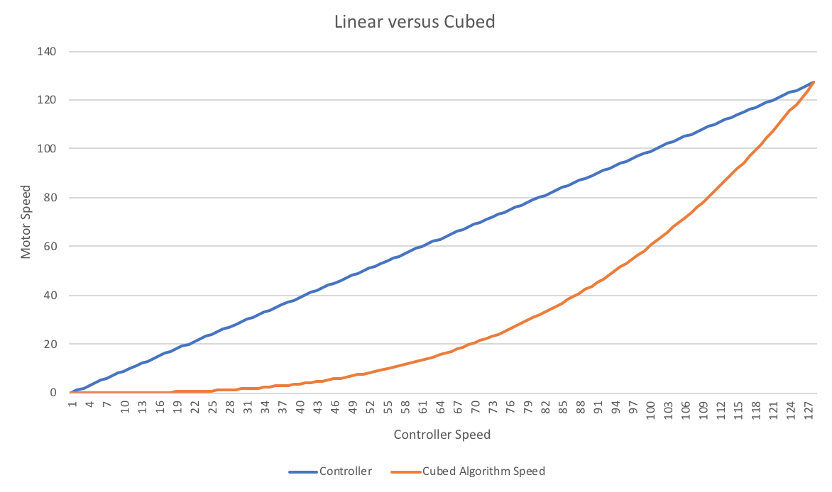

The math changes the response curve of your input to output, so joystick-to-motor in this case. I’ve heard it called a cubic control, since you cube the input and divide it by the max output, cubed. I’m not sure if that’s the actual name or not, though.
The two curves look like this:
linear-cubed
So same min and max, with a slow ramp through the low-middle values and gradual slope increase towards the max.
