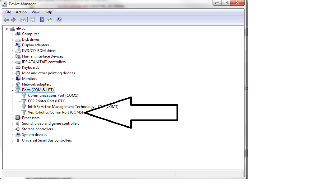

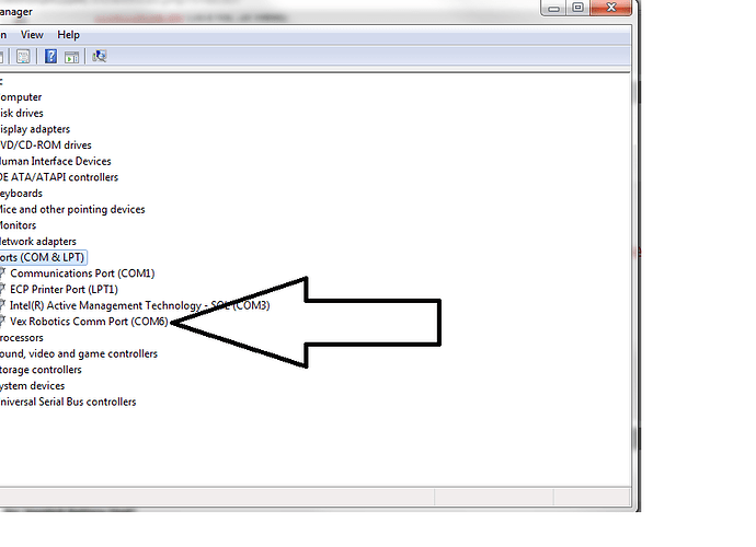

You might have to do it a few times before you get the hang of it, if it does not work please email [email protected] a screenshot of your Windows Device Manager “Ports” section as the Joystick is connected to the PC. It should look similar to the example attached.
