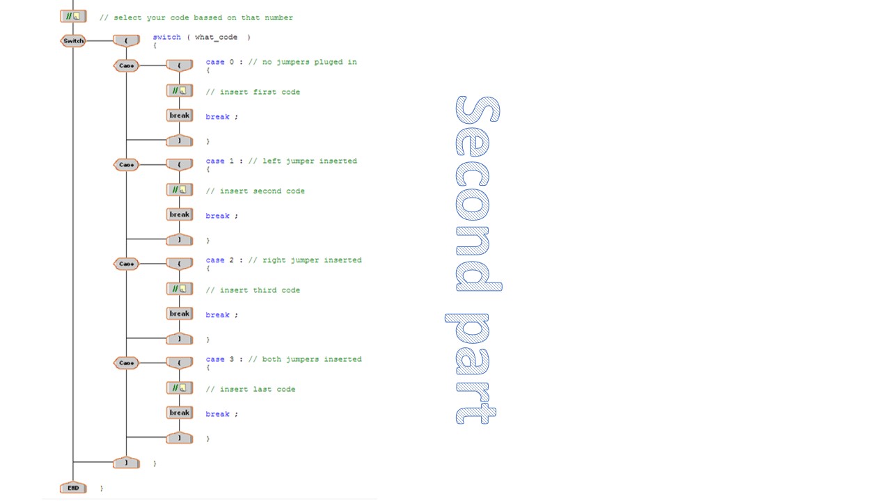

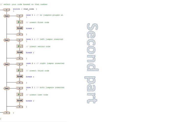

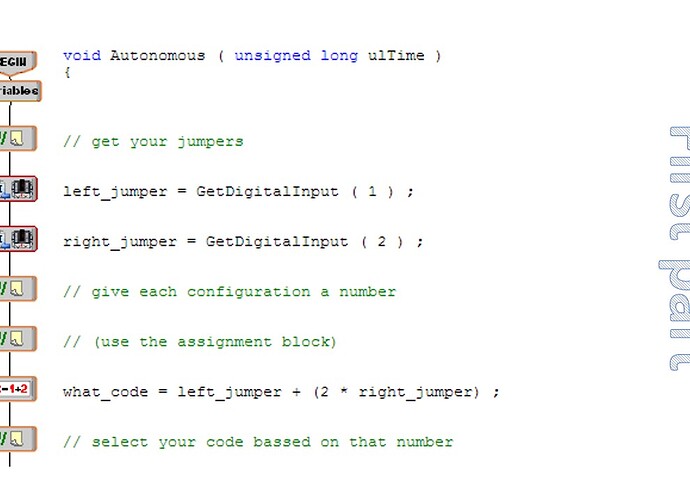

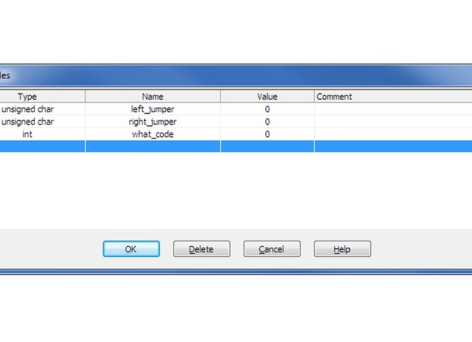

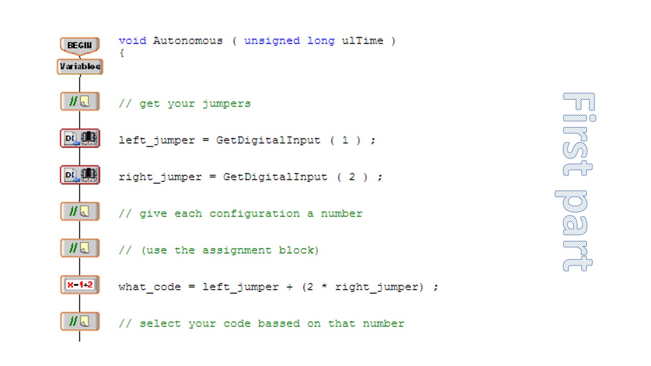

this program selects between 4 different codes based on input from two jumpers (right_jumper and left_jumper) and then gives each situation a number (what_code) then it uses that number to select which code you run.
#include "Main.h"
void Autonomous ( unsigned long ulTime )
      unsigned char left_jumper = 0;
      unsigned char right_jumper = 0;
      int what_code = 0;
      // get your jumpers
      left_jumper = GetDigitalInput ( 1 ) ;
      right_jumper = GetDigitalInput ( 2 ) ;
      // give each configuration a number
      // (use the assignment block)
      what_code = left_jumper + (2 * right_jumper) ;
      // select your code bassed on that number
      switch ( what_code  )
            case 0 : // no jumpers pluged in
                  // insert first code
                  break ;
            case 1 : // left jumper inserted
                  // insert second code
                  break ;
            case 2 : // right jumper inserted
                  // insert third code
                  break ;
            case 3 : // both jumpers inserted
                  // insert last code
                  break ;
I would recommend that the case 0 (when no jumpers are inserted) be a code that won’t mess up your robot if placed on a tile that it was not intended for.
That way if you loose your jumpers you won’t destroy your bot.
Best of luck to you and have fun programing.
Phillip.
EDIT:
This is in essay C but is only the text so you will have to recompose it somewhat. (not just copy and paste it)
It just occurred to me that I could post screen shots of the code to make it clearer.
