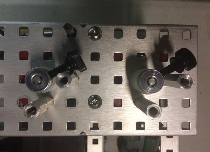

As a side note, it’s also common practice to use a potentiometer with a dial to select between autonomous routes. Simply say “when between 0 and 500, goto A, when between 500 and 1000, goto B, etc…” We often use a label maker to help us remember where each program is located on the range.
An example from our robot last year is below. The standoffs are to ensure it doesn’t go out of range.
