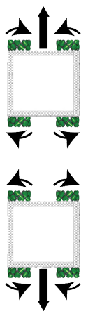

  4. How exactly do you code mecanum wheels for auton?(Probably a dumb question lol)

For coding mecanum wheels, the first thing to do is to make sure that they are put on correctly. The direction of the “spikes” of the wheels should be making an X. To move in the direction you want, you spin the wheels in the direction you want to go and on the other side, you spin them out. Here’s some sample code that used buttons and joysticks and here’s a visual from a while ago:
if(vexRT[Btn8U] == 1){
	 setMultipleMotors(speed, frontRight, backRight, frontLeft, backLeft);
else if(vexRT[Btn8D] == 1){
	setMultipleMotors(-speed, frontRight, backRight, frontLeft, backLeft);
else if(vexRT[Btn8L] == 1){
	setMultipleMotors(speed, frontRight, backLeft);
	setMultipleMotors(-speed, frontLeft, backRight);
else if(vexRT[Btn8R] == 1){
	setMultipleMotors(-speed, frontRight, backLeft);
	setMultipleMotors(speed, frontLeft, backRight);
else if(vexRT[Btn7L] == 1){
	setMultipleMotors(speed, frontRight, backRight);
	setMultipleMotors(-speed, frontLeft, backLeft);
else if(vexRT[Btn7R] == 1){
	setMultipleMotors(-speed, frontRight, backRight);
	setMultipleMotors(speed, frontLeft, backLeft);
else{
	motor[frontRight] = vexRT[Ch3] - vexRT[Ch1] - vexRT[Ch4];
	motor[backRight] =  vexRT[Ch3] - vexRT[Ch1] + vexRT[Ch4];
	motor[frontLeft] = vexRT[Ch3] + vexRT[Ch1] + vexRT[Ch4];
	motor[backLeft] =  vexRT[Ch3] + vexRT[Ch1] - vexRT[Ch4];
