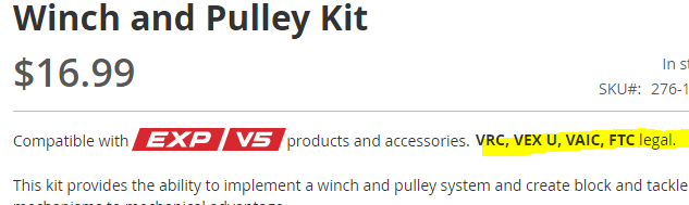

Take a look at R6 in the game manual. Subpoint (h) says you’ll find the the legality of parts on the vexrobotics website. If you look up the winch and pulley kit (Winch and Pulley Kit - VEX Robotics), notice that it includes a “rope”
Furthermore, notice the page tag that says it is a legal part:
I’m going to assume that you either have never read the game manual, or you didn’t know that a “rope” was included with the winch and pulley kit, because this comment makes little sense.

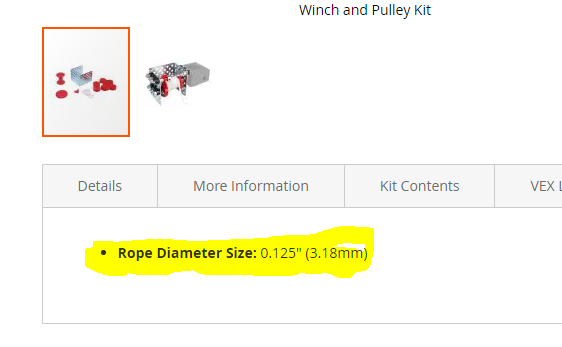

Rule R7 (e) gives the requirements for any non-vex rope/string you want to use. Do you see anything in R7e that declares a particular VEX-legal part, like the rope from the winch/pulley kit, to be illegal this season?

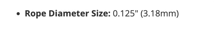

The diameter is listed on the “other information” tab:
