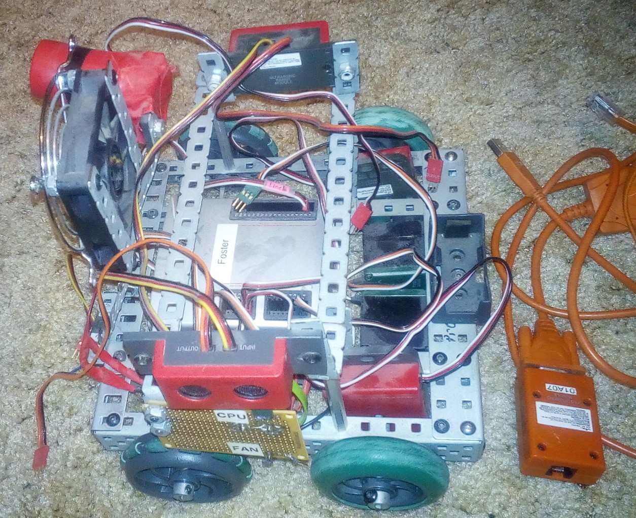

@Foster, I still have your old baby firefighting robot:
Do you want it back?
Or, if you still have programming tools and the code, I could try to revive it.
Wow, I haven’t seen that robot in YEARS, I’m thinking 2012 or 2013. Where did you find it?
It used a fan to blow out the fire. The red can is a film canister with an ir sensor to find the flame, the canisters blocked the ambient light.
Encoders to keep it going straight, the sonars let you know where the door openings and walls were. They really taxed the power of the PIC.
If you want to fool,with it, there is an archived version of Robot C on the Vex site. You have the program cable. Give it a whirl.
I have vague recollections that it entered a room, spun and if it saw the fire it would kick on the fan and spin side to side to blow the flame out. There was a rule change one year that you had to be within 18" of the fire to put it out, some of the bigger fan bots could blow it out from the doorway.
