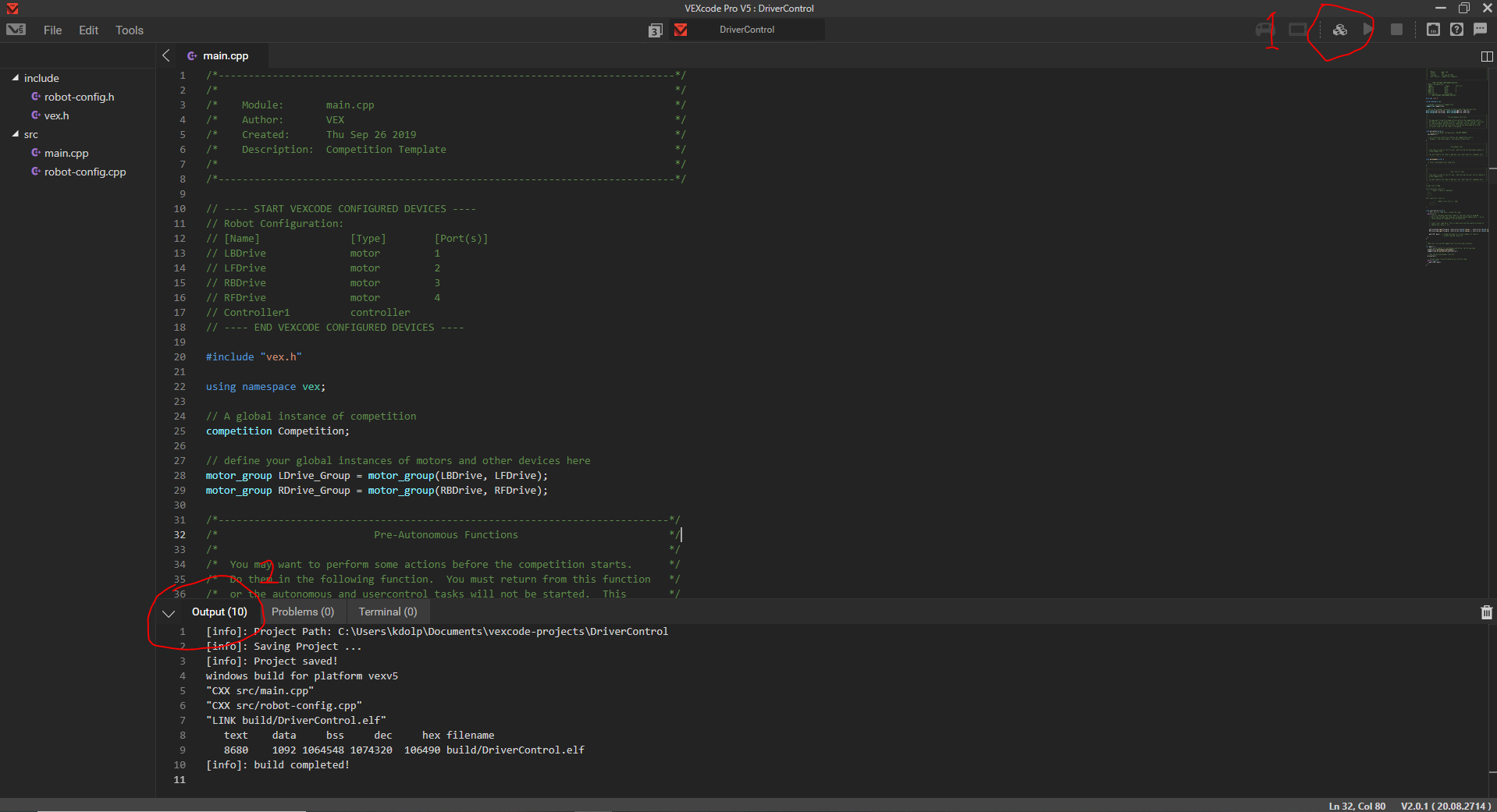

do any of you guys know how to see if your code works before you apply it to the bot?
I mean if you don’t see anything wrong with the code and you have no errors, the best way to see if it works is just to try it. Applying and testing your code on your robot is the best way to find problems and improve it.
Welcome to the VEXForum @bread1
As Xenon so greatly pointed out, if there are no errors, then the best way is to test it.
You can also build the program without compiling it, and that will give a more detailed explanation of the errors in the Output tab.
Build button is #1, the Output tab is #2
However, that solution really only provides more information on any errors that might be present, not if the code works.
