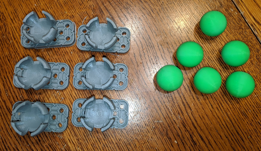

Just ordered a caster ball assembly from the 3D printer
I just ordered a caster ball assembly I found on Thinkiverse from the printer. He sent me pictures of the finished part. I am hoping they will work. I wish Vex would add these to their parts list.
bmp
Stay tuned…

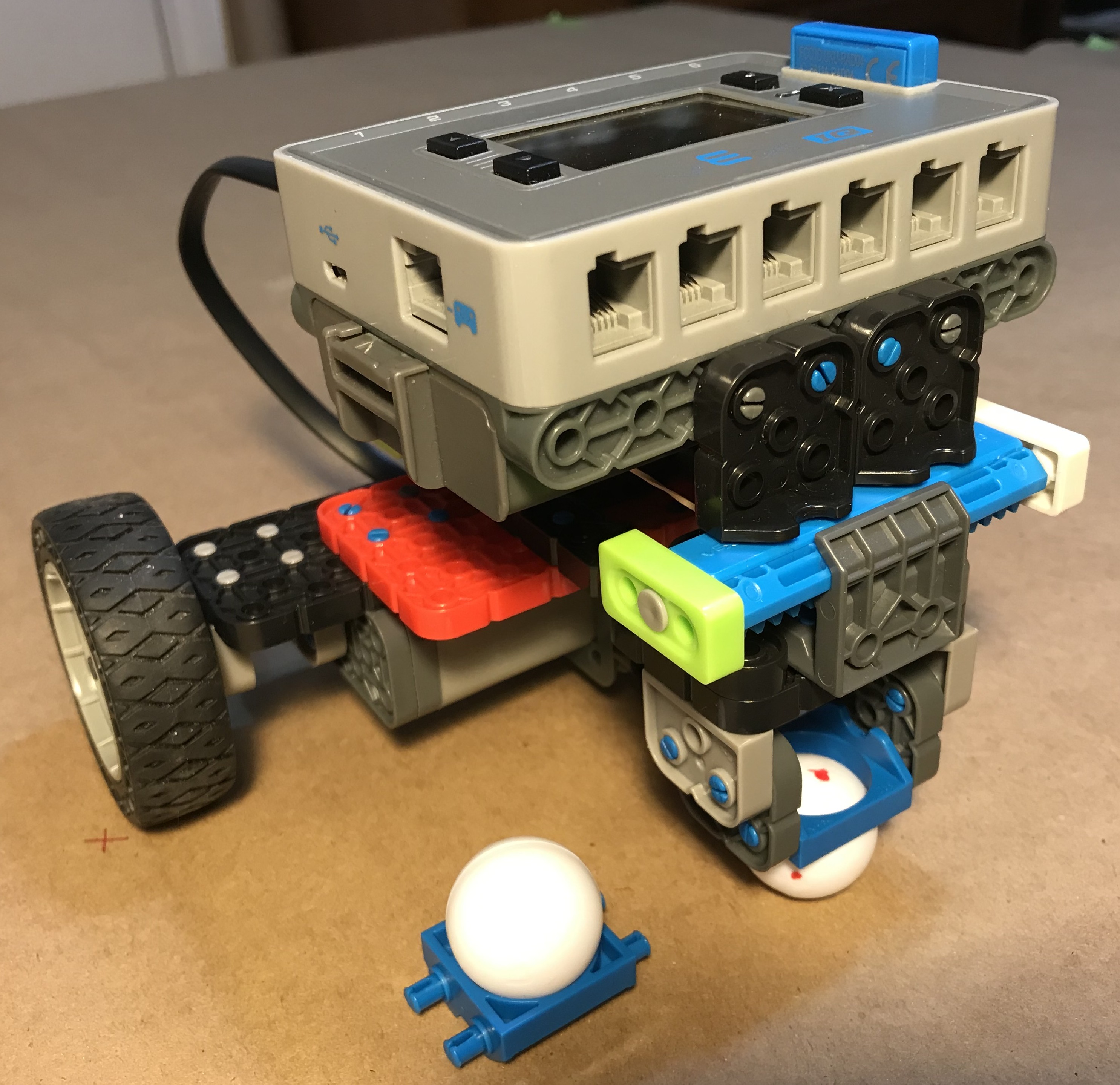

I know that FLL has them (we used them for our drivetrains). I too would have liked to have them as it would make it easier to build drivetrains in IQ (one motor per wheel- 2 wheels, then the caster ball in the back.
Standard Ping pong balls?
I saw one on Thingiverse that used ping pong balls, but this one uses one of the small Vex balls, so it is smaller than a ping pong ball.
You can already build VIQC-legal ball casters using:
1x 228-2500-507 2x4 25mm Ball Shooter Plate (Weak)
1x 228-2500-099 0x1 Sheet Attachment Pin
1x 228-2500-500 25mm Ball
Assorted pins / backing beam/plate on your robot
You can get 2x of the 228-2500-507 plates in the Catapult V2 kit. The Sheet Attachment Pins and 25mm Balls are already available in eponymous VEX IQ add-on packs.

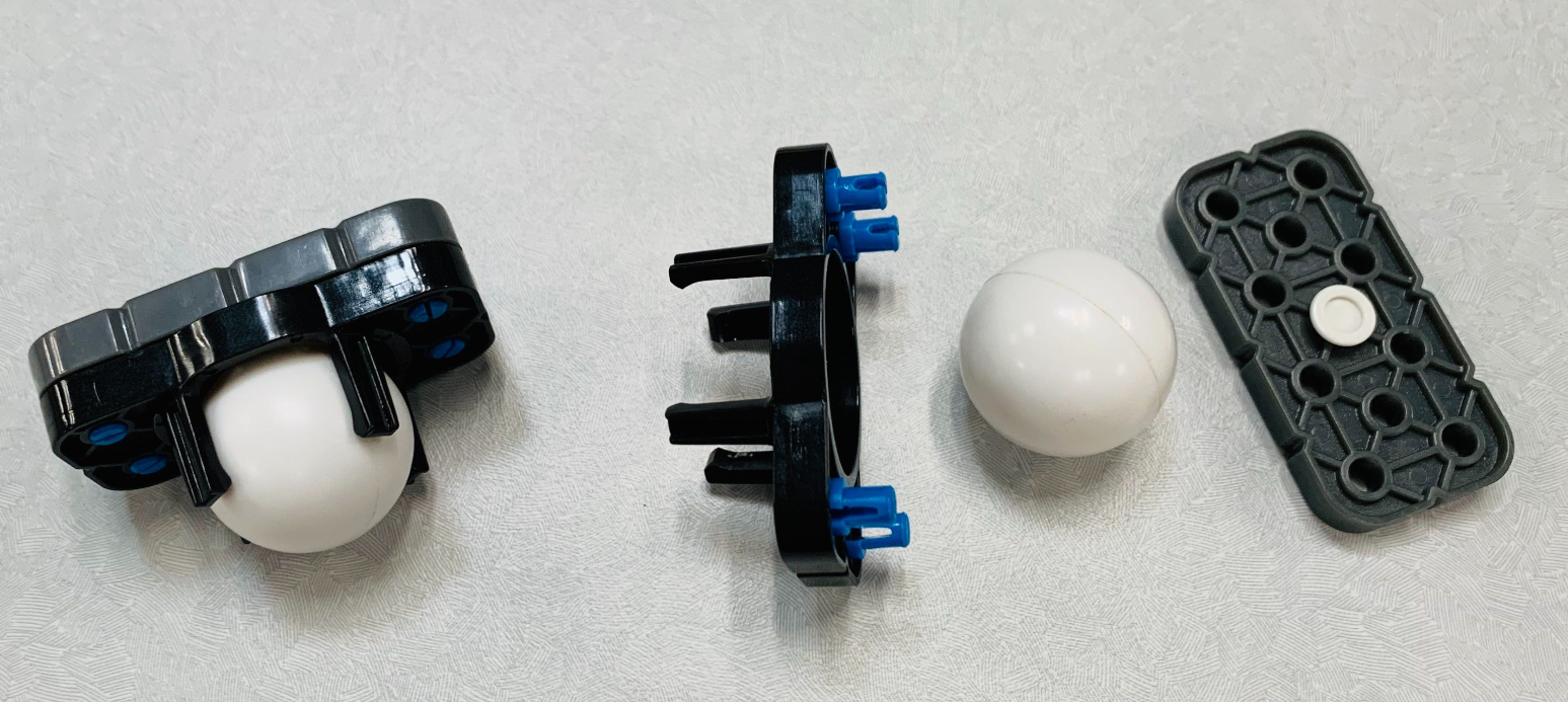

I was inspired by @Art_Dutra_IV’s comment, so I went to my Hexbug spare parts bin, and look what I found.
IMG_2312
So now I have a poor man’s version of a ball caster to use while I am waiting for parts to be delivered. And yes, I painted the ball so I could tell if it was rotating or not (it does!)
These are parts from the Hexbug Catapult Launcher kit.
Who knows what evil (parts) lie within the Hexbug parts library?
