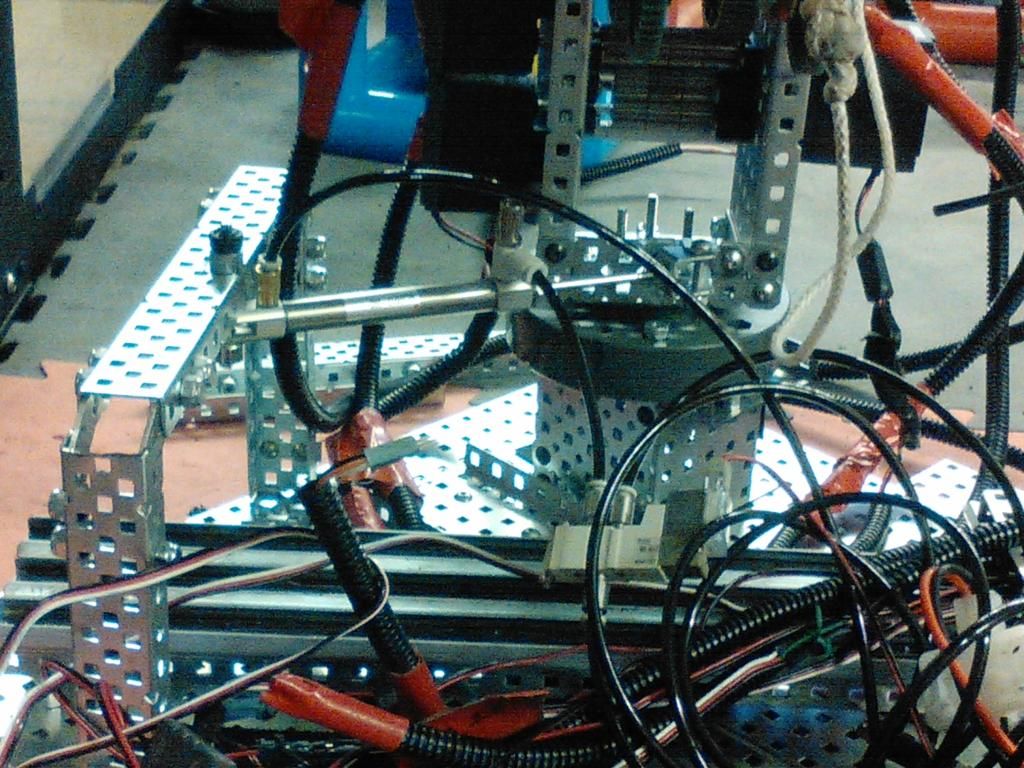

Is the “something that blocks” going to drag across the end of the piston and possibly bend the piston rod as something else moves? If that’s the case, then perhaps a seal could be damaged. We would need more description or photos to know.

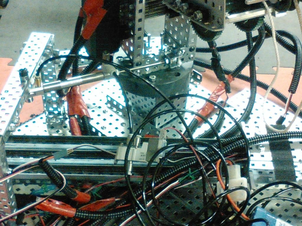

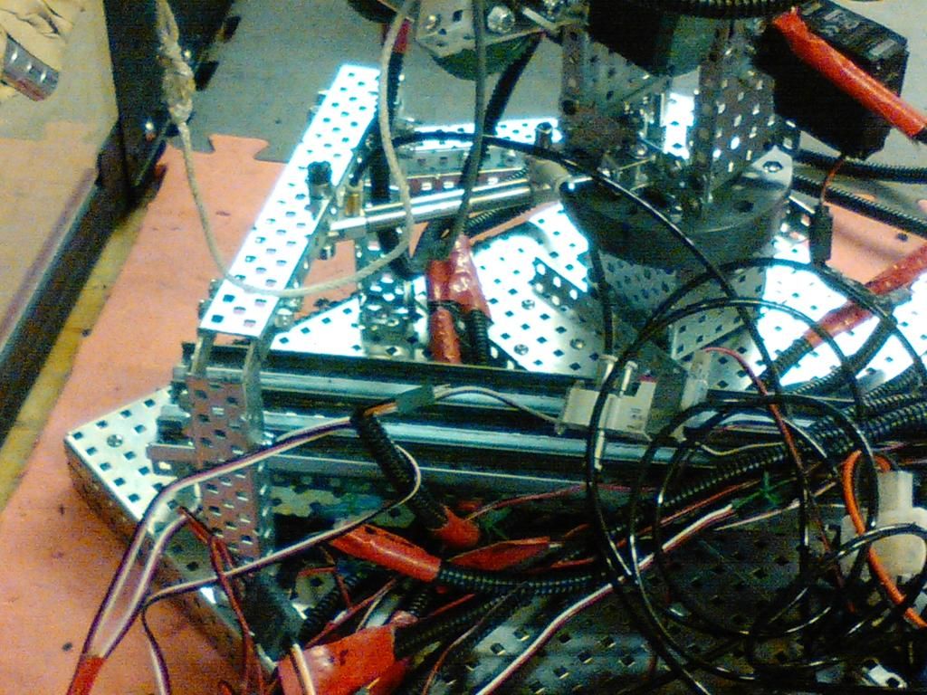

here are pictures.
Piston all the way in
Piston all the way out
Piston at the starting position

One possible solution might be to have something like a bar that hooks onto the frame of your turntable mechanism. The bar is held in place by the tension of the piston trying to push the turntable all the way around. When you are ready to deploy, you command the piston to retract. When the turntable turns around away from the hook, the tension on the hook is released so the hook falls away. Next, when you command the piston to extend all the way, the hook is no longer there, so the turntable can turn to its full extent. From then on, the turntable is free to turn back and forth to its full extent in either direction.
