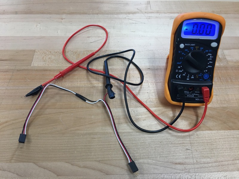

So, what were we hunting at the EC3 VEX lab? Better answers are those with some reasoning on why we were using this.
The perfect star!
An undamaged star will have higher resistance as compared to one that is broken and shorter.
And stars are in short supply…
We’d need an instrument to find and undamaged star; true. But no…
Looks like current draw since you are in line with the ground wire. Interested in the results.
Red wire, actually, but Kirchoff told us he was okay with the setup.

Though things went well for them at the tournament on Saturday, Team 6135K enountered an inssue in the last two rounds of the competition. Before the next tournament, they wanted to find and fix the problem.
I see the red wire now looking at the picture on my desktop. I couldn’t make it big enough on my phone last night. And the multi-meter is set on amps, so I’m definitely guessing current draw on motors. I would have used gator clip adaptors, just to make sure it has a good connection. We seem to experience more problems during semi-finals and finals just because the motors are getting used so much compared to qualifiers.
Alright, my knowledge of circuits is limited to textbook, not practical circuitry, but I’ll give it a go.
Multimeter in series: Measuring current of some sort.
Multimeter set to what looks like Amps: agrees with above
Experienced a problem: Needs to be solved through wiring of some sort ->motors dying, PTC trip, disconnect, etc.
My guess is that the problem you experienced is that your motors were drawing too much current, and thus tripped the cortex PTCs. You are measuring the current draw to more evenly distribute it among the PTCs.

I would almost say with as many motors we have tied together for our arms this year, trying to pinpoint one motor causing issues in a cluster of 4 to 6 tied together. Since taking an arm apart and testing them without load is quite different than directly after a match under load.
The only variable from the hints is how long did it persist after a match? Is that why they want to test it right away with an inline extension? (I’m curious as well now.)

My guess is they are having an issue with the mc29 motor converters that is giving you them inconsistent current. Listen to each mc29 and if you can hear any that click, feel warm, rattle, they could be the culprit. Also try shaking each, as we had one mc29 with an issue where it would stop moving if you shook it.
The other issue could be that you have a motor where the insulation ripped where the wires enter the case, which can create a short circuit and trip the circuit breakers.

The problem lies within a motor of the 6 motor arm, and at least (and most likely) 1 but not all of the motors are problematic.
This is a motor specific problem; anything that would affect more than one motor is not the problem.
Whatever the problem was, it affected how much current was drawn by a motor.
This is not a common problem; that is to say, it was not simply not having enough torque, it was not a cortex PTC trip, it was not a motor short.
It is more difficult/time consuming to take the motors off and individually test them than to jury-rig an ammeter.
This problem is not always present, rather, it was only present under heavy load. (Inferred from the fact that this is a monitoring cable, and that the problem presented itself at competition and not in practice before.)
I’m going to wildly guess that one of the motor PTC’s had gone bad in some capacity, and thus that motor browned out much earlier. However, I have no idea if that even matches the inferences I’ve made (affects current draw, etc.).

True within what you know. However, it is standard practice in EC3 (and many other labs) to use Y cables on pairs of motors driving structural-joined members. Things like arms and lifts. Note that it’s necessary to do that if you want to use 12 motors, which is something you should assume likely if pneumatics aren’t mentioned. In addition, it is standard practice in some labs/programs/teams to avoid ports 1 and 10 (the H-bridge ports) if possible. This makes the use of Y cables even more likely. So, given that it was a lift, it was likely that the problem motor or motors was connected via a Y cable. Keep that in mind when someone describes a problem they’re having.

Yes, but… Is it possible to individually test motors without taking them off? Is that something an experienced builder would do? If that had produced the answer, would you need an ammeter?
Not in evidence. That is, there isn’t enough information to make that assumption.
You haven’t built quite enough foundation just yet to make that assumption. You are on the edge of a couple of useful details. You should consider the ways in which a motor or motors can fail to provide enough motive force to make the lift work, or at least to work well in competition.
If you researched using the team number (6135K) and the timing, (puzzle posted Feb 10, about a problem solved that week) and knowing they were in a tournament when the problem arose, what would you find?
