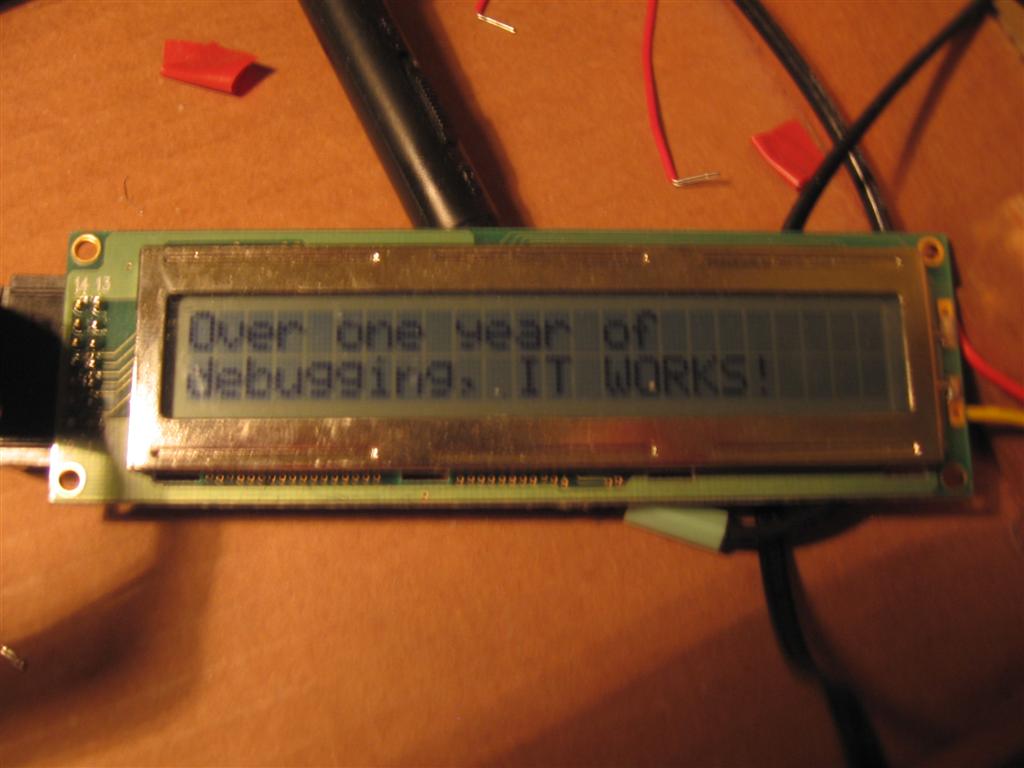

Hooray! I got the LCD done, now im just one step closer to working with the laser.
great, could you post code and pics?

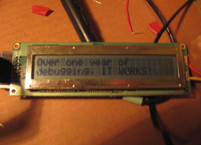

As i said, it’s unrelated to VEX, but anyways, here it is: (picture in attachments)
The controller i used was a OOPIC (http://www.oopic.com). And the LCD i used was from B.G. Micro (bgmicro.com).
the code:
Dim LCD As New oLCD
Sub Main()
LCD.IOLineRS = 14
LCD.IOLineE = 15
LCD.IOGroup = 3
LCD.Nibble = 1
LCD.Operate = 1
LCD.Init
LCD.Clear
LCD.Locate(0,0)
LCD.VString = “Over one year of”
LCD.Locate (1,0)
LCD.VString = “debugging, IT WORKS!”
End Sub

Your using a independent power supply, right?
one year of debugging!!! i used my lcd (the parallel type not serial) with my basicx and basic atom, took me about 10 minutes, my serial one took about 3
If i know what your saying, its hooked up to a powersupply (away from the vex), and its part of a separate project
lol…total, i have bought 3 parallel LCD’s, and 2 attempts. The first attempt, the data sheet has some “un-mentioned” specs, so that lcd has been trashed. what i mean by “un-mentioned”, is that the sheet says it has a total of 14, but the LCD had 16, so i assumed the inner pin was 1, WRONG. before the first pin, i found small lettering on the board “K” and “A” (for the back-lights). On attempt 2, (I am clumsy, plz dont laugh) I had mis-wired the whole thing (due to my clumsiness). About a month later from the second attempt, i re-checked my wiring and found that all are wired backwards. I corrected the LCD’s, and yay, it worked. the first LCD i bought was from jameco (mfg.: Hantronix, cost: $20.00), and it was trashed by lack of specs… On my second pair of LCD’s, I bought them from a surplus store costing less than $5.00. whats so surprising is that the cheap LCD (from the surplus store) is VERY durable, it can withstand shorts for a long period of time, while the costly one, is just easily broken.
