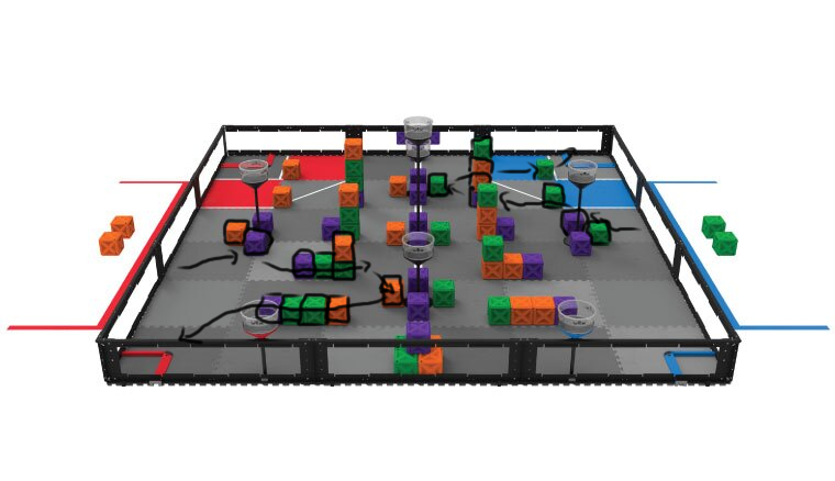

autons
these are the sorts of autons I expect to see by worlds.
right now robots aren’t fast enough to do either of these, but by worlds they probably will be. the unprotected zone auton will be favorable for traybots, while the protected zone route will be favorable for lifts (or until traybots gain the ability to intake that 4 tall tower with ease)
autonomous points will probably be the defining points in the match.
