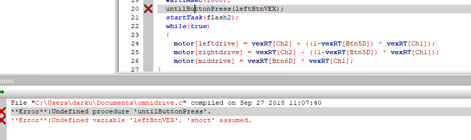

im attempting to get the left button on the lcd to be what starts up the rest of the tasks after the lcd display turns on. like an activation confirm button. nothing does anything on the robot after the lcd displays its text until the button is pressed
So the function is here in the helpdocs.
http://help.robotc.net/WebHelpVEX/index.htm#Resources/topics/VEX_Cortex/Natural_Language/PLTW/UntilSensor/untilButtonPress.htm
That function is under the PLTW NL “library” so what you have to do is enable Natural Language under the robot menu in ROBOTC.

heres what i want:
when i power on the robot, it will display this on the screen using this code:
clearLCDLine(0);
bLCDBacklight = true;
wait1Msec(100);
displayLCDCenteredString(0, “Darkez Model:”);
wait1Msec(1000);
displayLCDCenteredString(1, “H.D 9.X”);
i want this to remain as is until the button is pressed on the lcd screen. additionally, until the button is pressed, i dont want the controls to work. i want the robot to remain “disabled” until i press that button. once that button is pressed, i want the robot to become “enabled” and responsive to the controls. here is the sample of my entire code without the separation command.

how do i accomplish this

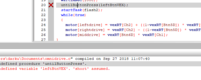

Ya just put the untilButton line right before
startTask(flash2);
i did that but it was coming up with the error as shown in the first picture
this error again. it wont recognize the command
