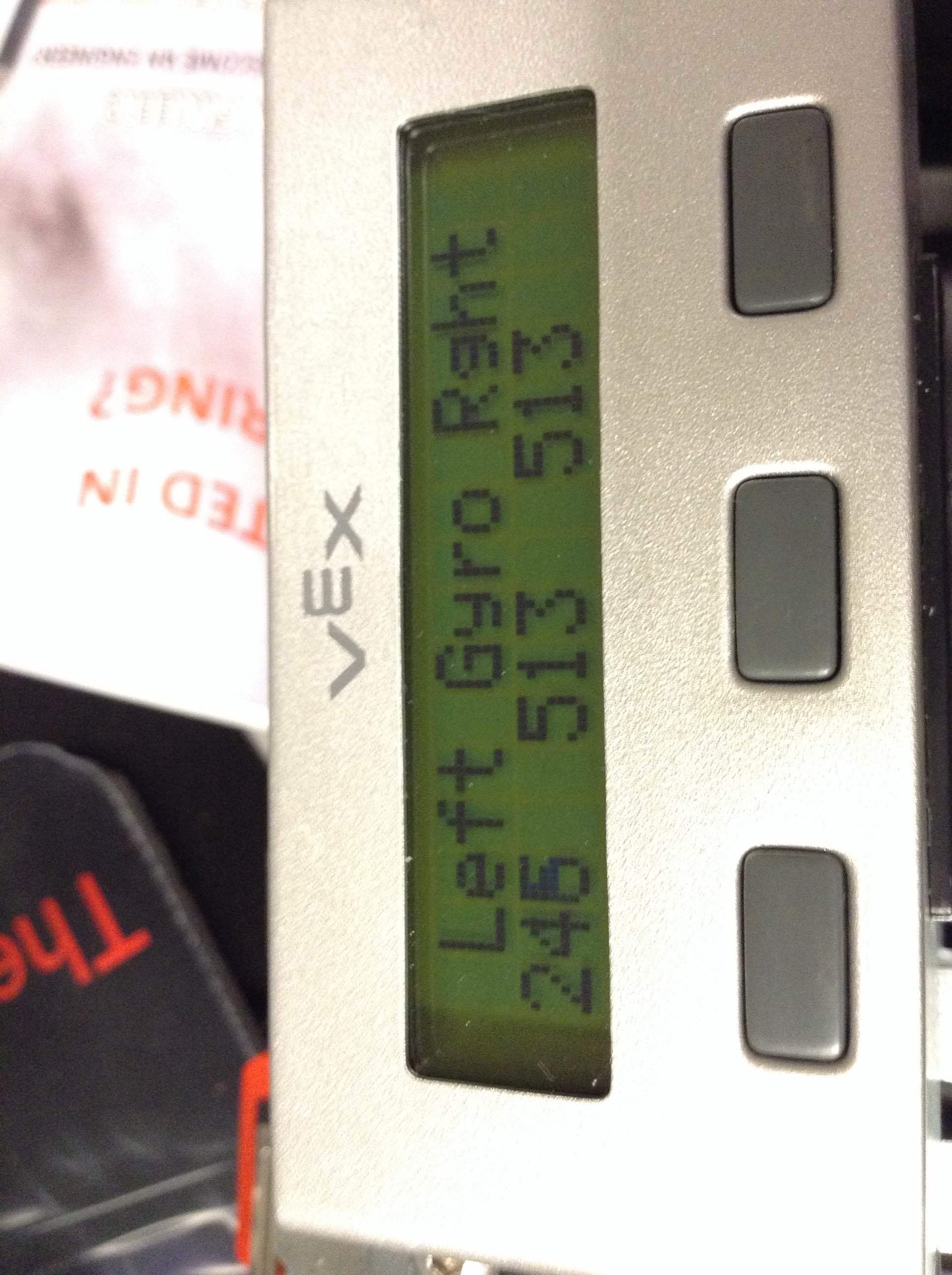

then when I add this code the autonomous will not run and the screen goes blank(note that leftMotor and rightMotor are calling IME values)

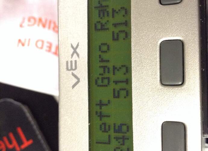

With this code i can see this and autonomus will not run
Thank you for the help
Zach
Hi Zach
The reason your code does not work as intended is because you have the lcd display in an infinite loop, that is, you have it inside a while(1) loop. This means that you never reach and are able to execute the rest of your autonomous code. The best way to solve this is to place the lcd display code inside a separate task and start that at the beginning of autonomous, something like this.
