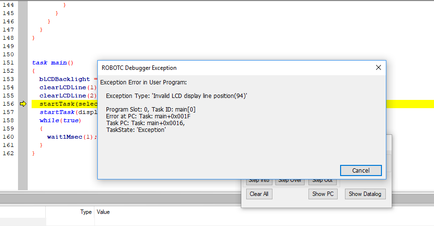

I began writing some code for a basic autonomous selection using the LCD screen, and here is my code so far:

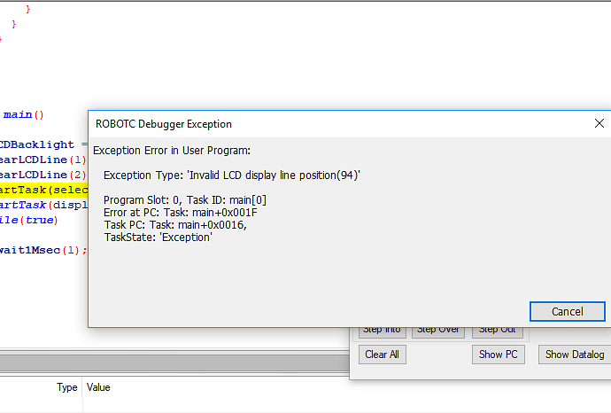

The code compiles without any errors, but when I try to run the program in the debugger windows, this is the error I get:
The lines on the LCD are called 0 and 1, not 1 and 2. In Main you clear lines 1 and 2, but line 2 doesn’t exist.
facepalm thanks for the help
