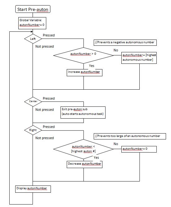

I was just wondering if anyone has LCD code that could change between different programs (about 4 programs). Does anyone have this code that they would like to share?

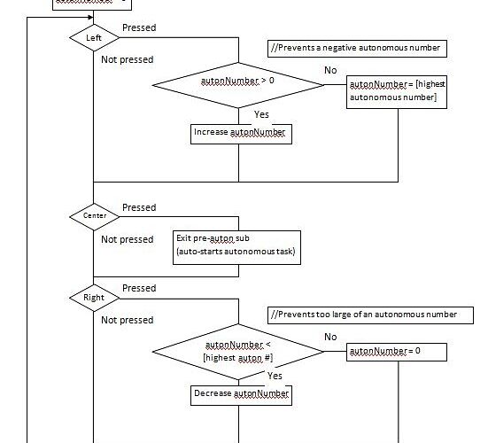

One thing I like to do when creating a program like this is to write out a flowchart. I’ve attached one for this type of program in *.jpg format. (if you need another format, let me know) As far as the actual coding goes, I’ll let you figure that out… :stuck_out_tongue:
In the autonomous task, just use either a select-case or if/then series to run the proper autonomous code based on the autonomousNumber variable.
Hope this helps,
Andrew
P.S. After creating the file, I realized that the “display autonomousNumber” step should only be triggered if either the left or right button has been pressed. This is for more efficient code, and it is easier on the LCD screen.
P.P.S. Sorry about the poor resolution - I didn’t have a lot of time to make it…
