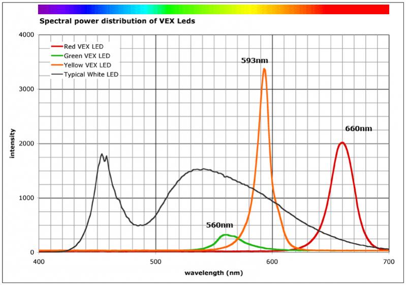

To make many of the measurements used in color science an instrument known as a spectrometer is used, now I just happen to have access to this type of equipment so decided to make some measurements of the light sources we have available from VEX (ie. leds) and the reflectance of the blue and red field tiles.
Measuring the light sources is the easiest, here is (more or less) the spectral power graph for the three VEX leds as well as a white led flashlight I have (unfortunately I don’t have a VEX flashlight to measure).
[ATTACH]7620[/ATTACH]
The X axis of this graph is the wavelength of the light (you could think of it as the color of the light). The Y axis is the intensity of the light at that wavelength (think brightness, although that is over simplified). The green led is rather pathetic, not much light output there, yellow and red are both quite reasonable. Notice how the spectrum of an led is very narrow, only 10nm to 20nm at the 50% point. The white led has a much broader spectrum with two peaks, I would assume that two different elements/materials are used. One centered on green with a wide spectrum and then a secondary blue emitting substance used.
