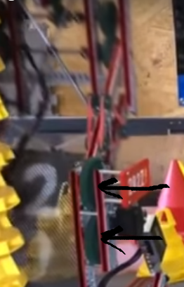

The other thing you can do is to attach a gear to both bars on the bottom 4 bar to help keep them parallel. 202Z used this technique last year to help them build (to my knowledge) the most stable lift in the world. You can see this really well at 0:39 when you have a clear shot of their lift. Pay attention to their lift tower and look closely at the gearing.
I’ve also attached a second image that more clearly points to exactly what I’m talking about.
