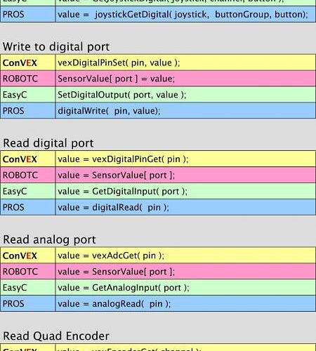

JPearman actually made a really good comparison chart of all four prevalent Vex languages. Here it is:
