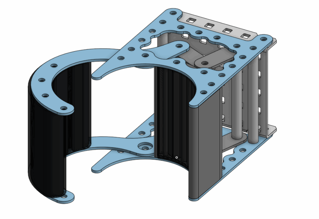

Linkages are very fun to get into! The concept of an over-center linkage is, in my opinion, one of the most fundamental things to learn about linkages. It’s very versatile and the concept can apply to all sorts of things, especially climbing claws or anything else that clamps onto stuff, or deploys and needs to stay deployed. If you have a pair of locking pliers, those are a great example.
Optimizing leverage and making a linkage strongest where you need it to be is a pretty great skill to have, and can make you a very valuable mechanical team member.
Anyways, here’s the claw I made last year for over-under. I compete in VexU, so these parts are made from CNC aluminum plates, 3D prints, and cast urethane rubber, but these concepts still apply to vex parts.
pocssc
Notice how when claw is closed, the over-center is straight and the claw’s lever is perpendicular to the over-center linkage. This means that the only way to open the claw once it’s closed is by pulling the over-center back away from the plate (or breaking things I guess). The fact that the lever is perpendicular simply gives it the maximum possible amount of leverage. It’s not a very complex or impressive linkage system, but the simplest solution is often the best.
Very cool, thanks for sharing this with us.
