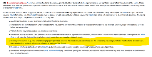

My team would like to implement LED bulbs (the type that cannot change colors and have positive and negative wires only,) and attach these around our robot as a decoration.
Would it be legal to connect these to a 9V battery mounted on the robot separate from the brain and, if not, how would we power these from the brain?
An example:
(Redirect Notice)
Hello! This is a question that can be answered by reading the VEX game manual, more specifically the rule R8 about non-functional decorations.
However, since you are a first time user:
Yes, it is legal to use a seperate 9V battery for the sole purpose of powering those lights.
