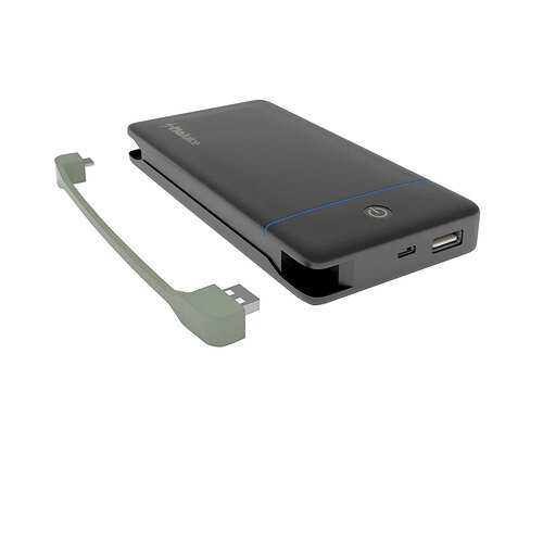

The topic of LED Strips has come up a thousand times I believe, but is there a possibility of running a strip that has a USB connector that is plugged into a portable phone charger like this one?
On a robot, during competitions?
Absolutely not. Edit: see below

Yeah, as soon as I posted this, I found like 4 other posts that said this was illegal. I was going to put this on a competition robot.
You can however power the lights from the brain. Let me know what system you’re using (cortex, V5) and I can help you power them with the brain itself.
Actually the RECF made an exception on the Q&A.
See for yourself: Q&A: Do LED strips still need to be powered by brain/cortex
…using a small external power source to power a standard LED strip would be permitted, provided that no other rules are violated, such as R12e, R12g, or G10.
