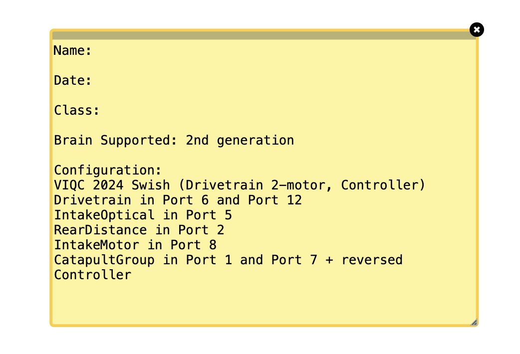

So, are you using the preset Drive program on the vex iq brain? If you are, then the motors could be plugged into the wrong ports.

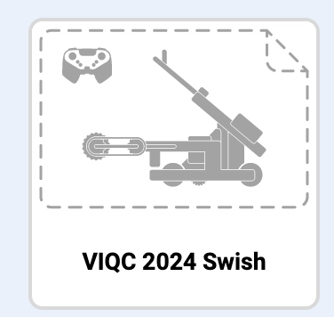

The easiest way is to code swish is to open Vexcode iq (https://codeiq.vex.com), then press File → Open Examples → then scroll down and press the following icon.
Lastly, follow the comment block and plug in the robot as directed.
