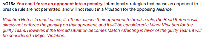

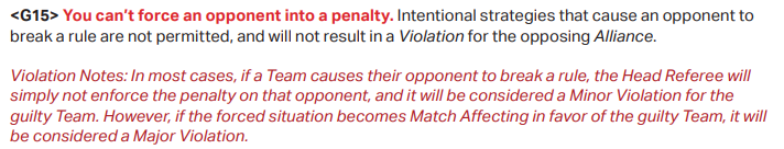

As for the point raised about using a mobile goal to nullify an opponents hang… SC7.c does state that contacting a mobile goal nullifies a climb, HOWEVER, if you cause the mobile goal to contact an opposing robot in such a manor, you would be violating G15 and either the climb would still count or you could have a match affecting major violation.
G15 only deals with penalties, however SC7.c does not state that it is a violation to touch a mobile goal, just that you won’t be counted as hanging. A violation of G15 would be forcing the opponent to possess two goals, which is illegal.
Touching a mogo while climbing is not a penalty, it just is not scored. Therefore you are not forcing them into a penalty, you are just preventing them from scoring and g15 does not apply.
Similar to how if you block the high stakes and prevent your opponent from scoring on the high stake you are not forcing them into a penalty, you are just preventing them from scoring, touching your opponent with a mobile goal is not forcing them into a penalty, it is just preventing them from scoring.
