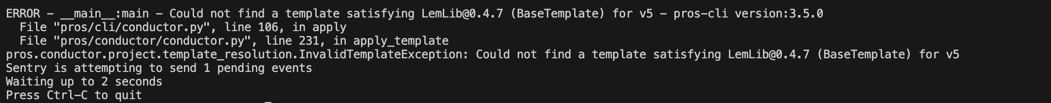

I’m trying to start using LemLib and I’m running into errors installing it. I installed the zip to the project directory and navigated to the directory using the pros terminal.
pros c fetch [email protected]
works fine
pros c apply [email protected]
however, runs into this error
This error usually happens when your version of PROS does not match the version of PROS LemLib uses. LemLib uses PROS 3.8.0 and does not support other versions
You can fix it by running
pros c install [email protected]
then you can try to reapply the template
I tried downgrading , and no results, I got the same error as Niikkc (see attached image below)

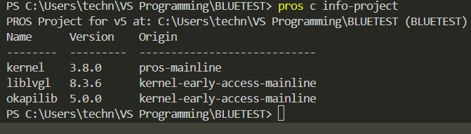

Can you run pros c info-project and post the output?

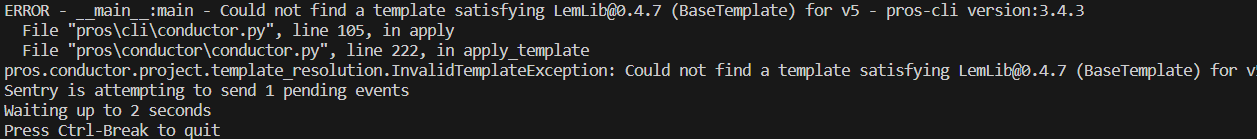

I am having the same problem,
error
