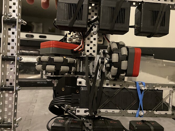

I was setting up a lemlib odometry system but it is having problems calculating a straight line. I will push it forward a field tile in the Y direction and it will give me around 24 Y and 2 X even when I push it against a wall. This same thing happens with the X direction. Is this normal or is there a problem with my code.

Can you send a picture of your robot? If your tracking wheels are not perfectly perpendicular with the drivetrain you might run into issues.
These are the pictures
Two things that might be happening is that if you are using 2.75 wheels for the odometry and your drivetrain is 3.25 you might have to account for that if you already haven’t. Also while this is unlikely because you are using old sensors they might be going bad or be less accurate then the new ones.
