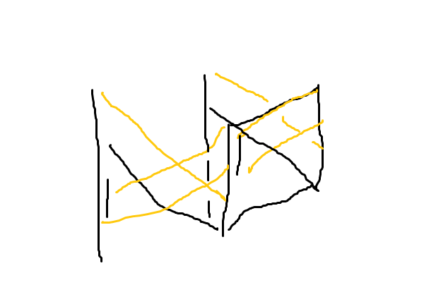

Unfortunately, I only have enough go get one pack right now, i did a quick drawing and I have the yellow as aluminum and black as steel. Is there any better way to reposition the bars? image
Not bad. But, I’d try to keep all the steel closer to the towers, so at least your center of mass will be lower. Perhaps make the first 4 bar all steel, and make the center tower and upper 4- bar mostly aluminum. Also, consider gearing in the center column, and please rubber band the lift.
I agree with this, if you’re going to use steel, you might as well use it on the lower arms to keep the top as light as possible.
