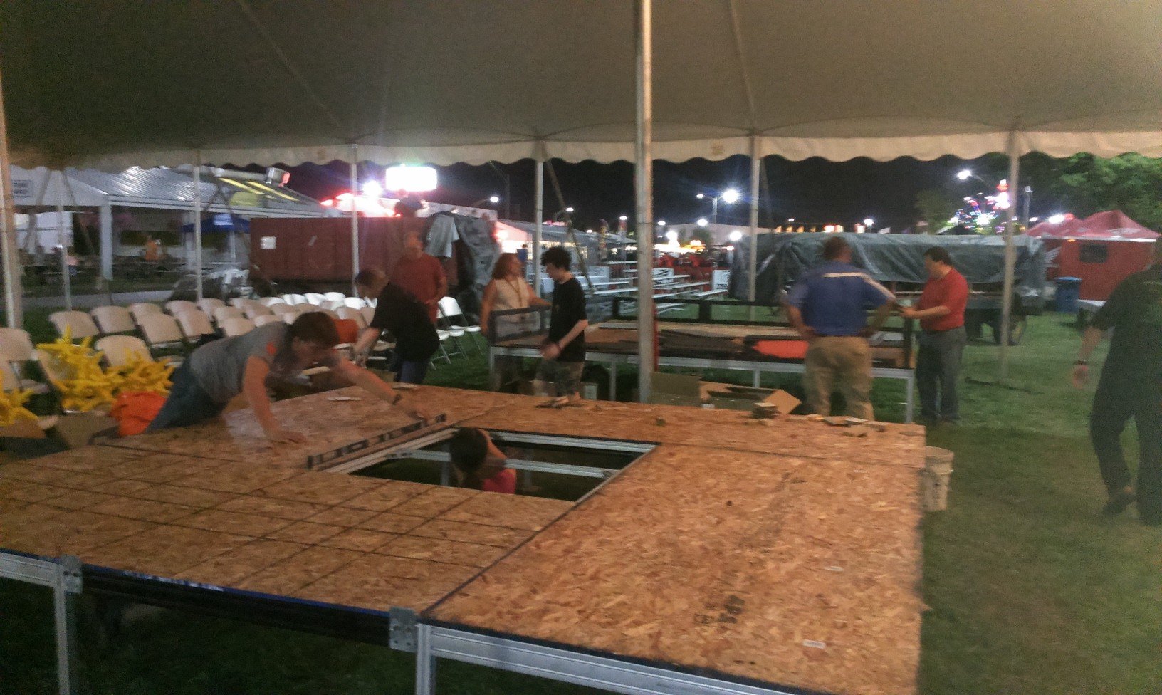

At our Monroe County Fair Event, our field-levelers are working to level our field risers. This event is held outside under a tent on a grassy lawn, so there’s no choice but to use field riser. We have dozens of wooden blocks and shims, and get the fields level to within about 1/4" in four feet.

I think a field which is not quite level will probably be fine. It will just require teams to pick up on it, see how high they can safely stack and then adjust their strategies accordingly.
I would love to have VEX or RECF standardize the field risers and make something available for sale / rent. We could buy 4 or 5 for FL and share accordingly. But as always the cost will get passed on…
