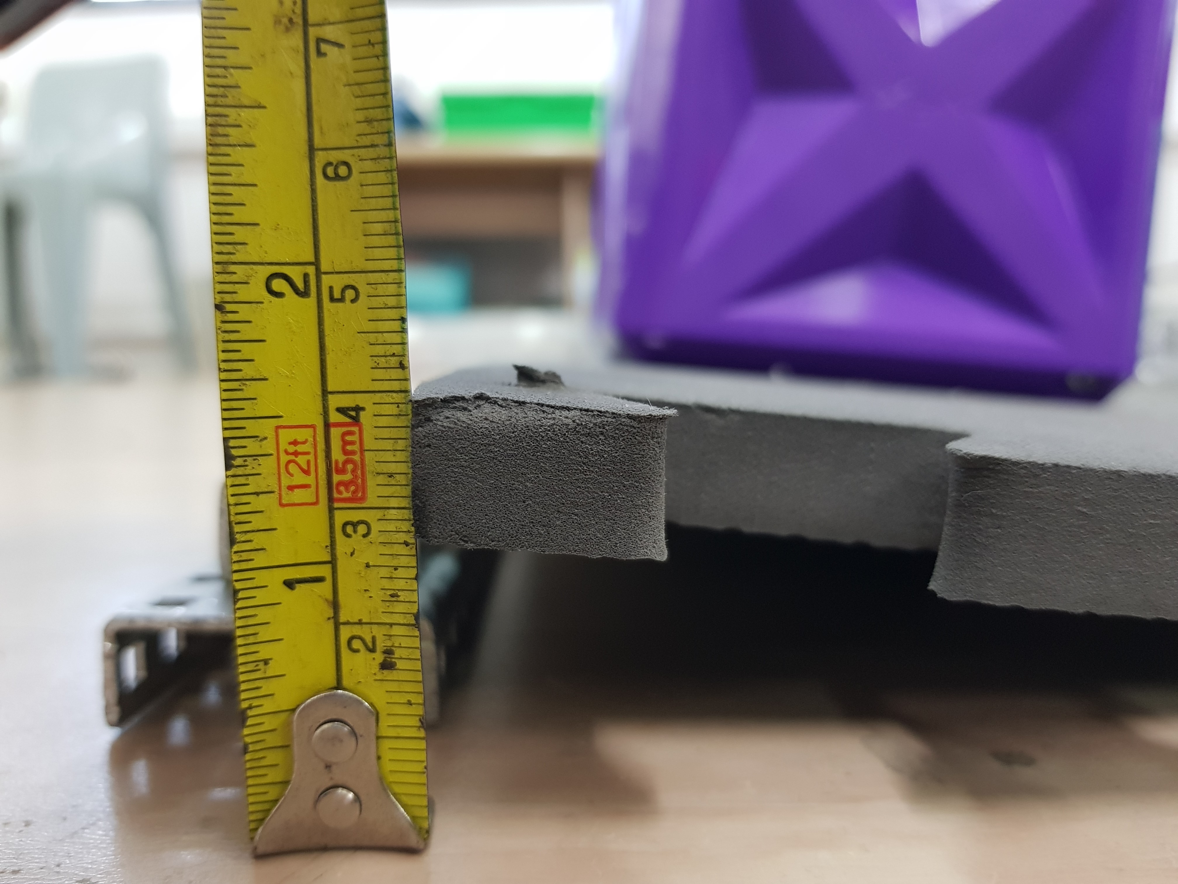

done a quick, basic test…
1inch
This is at 1" - max tolerance limit.
And we loaded the cubes manually, one by one and also as an entire stack - the results are similar.
(But do note that I believe robot doing the stacking will probably fair worse than manual stacking).
And this is at 1" tolerance limit, and the situation when it was 5 cubes high.
The stack toppled at 6-cube high.
tilted%20cubes
We then moved it up to 1.5"… just half an inch above the limit, and the highest stack dropped to 4-cube high.

@meng’s demonstration is extreme, yes. Has anyone actually seen that in a competition? It looks like that setup is a 1" bump under one edge of a tile while the other edge is on the ground - i.e. 1" rise over 24". Such a bump would cause other issues with the field perimeter and such. I think if anyone saw that extreme of a condition they should politely ask the EP if it can be mitigated.

Nope. It is not over 1 tile.
I inserted a large piece of polycarbonate below the foam tiles.
Granted that it did not stretch all the way to the centre of the field (I didn’t have such a large sheet), but it went about 3 tiles in.
Let’s call a spade a spade, tilted field will definitely affects game play, and some games will be affected more than others, eg. Skyrise vs starstruck.
But still, as Long as it is within the specified +/- 1”, I really think teams can’t complain about that.
I mean, teams will need to design their robots and plan their gameplay within the expected tolerance limit.
But anything more than the specific limits will be unfair to the teams.
Edit: think the zoom-in view (I.e. 1st pic) makes it looked extreme, but when looking at the 2nd pic, the tilt is not exactly noticeable. And the stacked cubes actually slowly slided off. It took a while for the cubes to reach equilibrium positions.
So it was definitely not an extreme tilt.
But that said, if we are looking at max limit, think it is not wrong to look at 1” rise over 24” (1 tile) as well.

Your demonstration is 1" rise over significantly less than the full field width, meaning if the whole floor was tilted that much it would be more than 1" over the length of the field which I would say was out of spec. But again like @Hudsonville_Robotics said I doubt you’d find any venue floor sloped that much.
