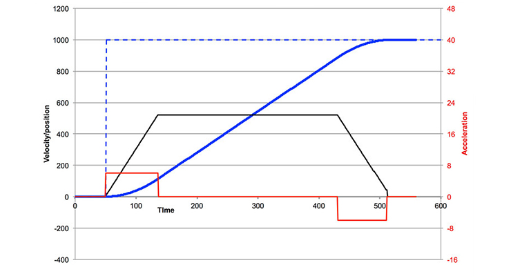

Now, there’s another issue that I did not talk about with a valid solution, momentum.
Lifts carry momentum, and just telling a motor from 0 to 12 in voltage will damage the motor as well as the lift’s integrity over time. One thing to consider is motion profiling:
It is where you apply a graphical formula into your PID control loop to emulate smoother transitions between speeds. I have not been exposed much to motion profiling, but I am assuming it is not as hard as you would believe it to be (according to my peers).
