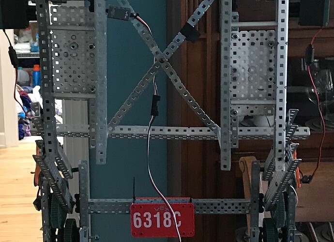

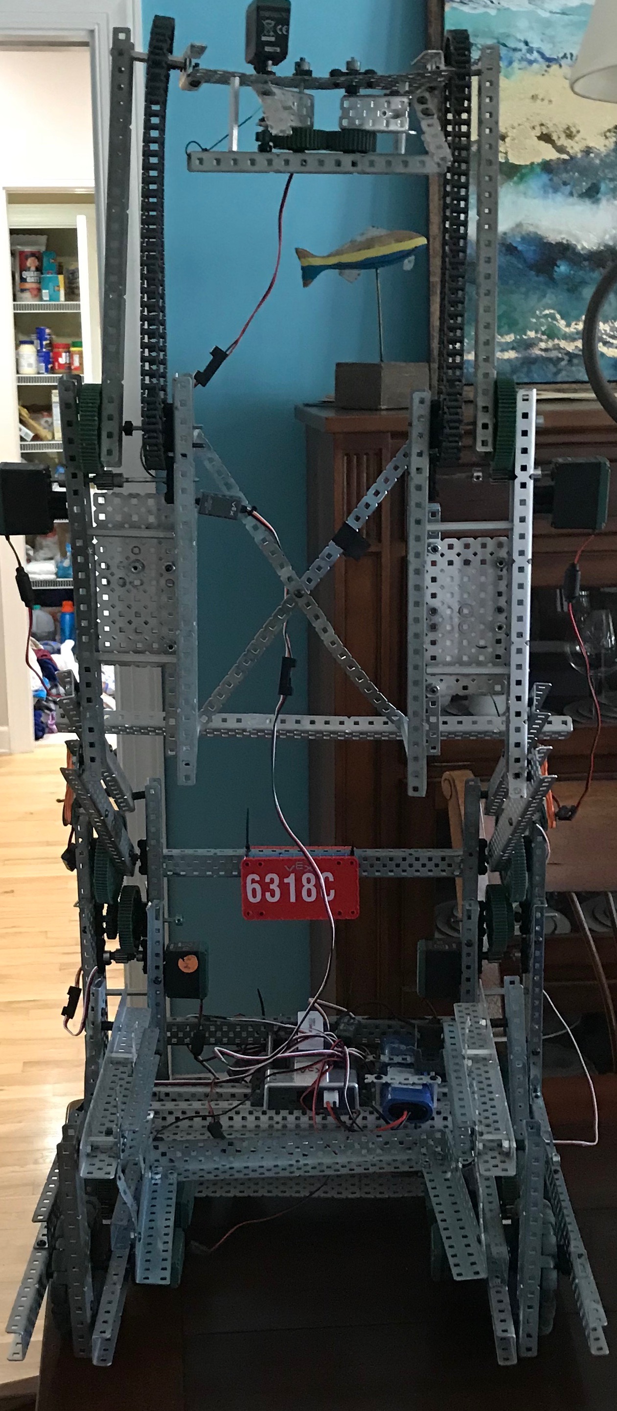

I currently have a robot that can externally stack about eleven cones on a mogo. Would it be worth it to change the design in order to be faster and stack the cones internally, but only be able to stack 7 cones?

#11
could you post a few pictures so people can give you ideas on what to improve on?
#12
My lift is a four bar that goes into a chain bar. These two are not mechanically linked. The redesign will involve shortening the chain bar, and moving it down. Currently, we have to drop the cone for internal stacking for the first four cones. The new design will allow me to brace the lift better. Also, the program will be the exact same.

#15
I’m not sure if I’m correct or not, but is your four bar using compound gearing? That is one of the reasons why the lift is slow imo. If you have spare money, I’d recommend swapping all of the lift to aluminum to ease the stress on the motor. this can allow you to gear the four bar at a more reasonable speed like 1:7 or 1:5. As for the cone dropping issue, you can do that simultaneously with the changes to the four bar as they are separate.
#16
Yeah, I am using compound gearing. While designing this lift, I forgot about the awesome power of rubber bands. I will change the gearing to 1:7 and use better tensioning.

#18
