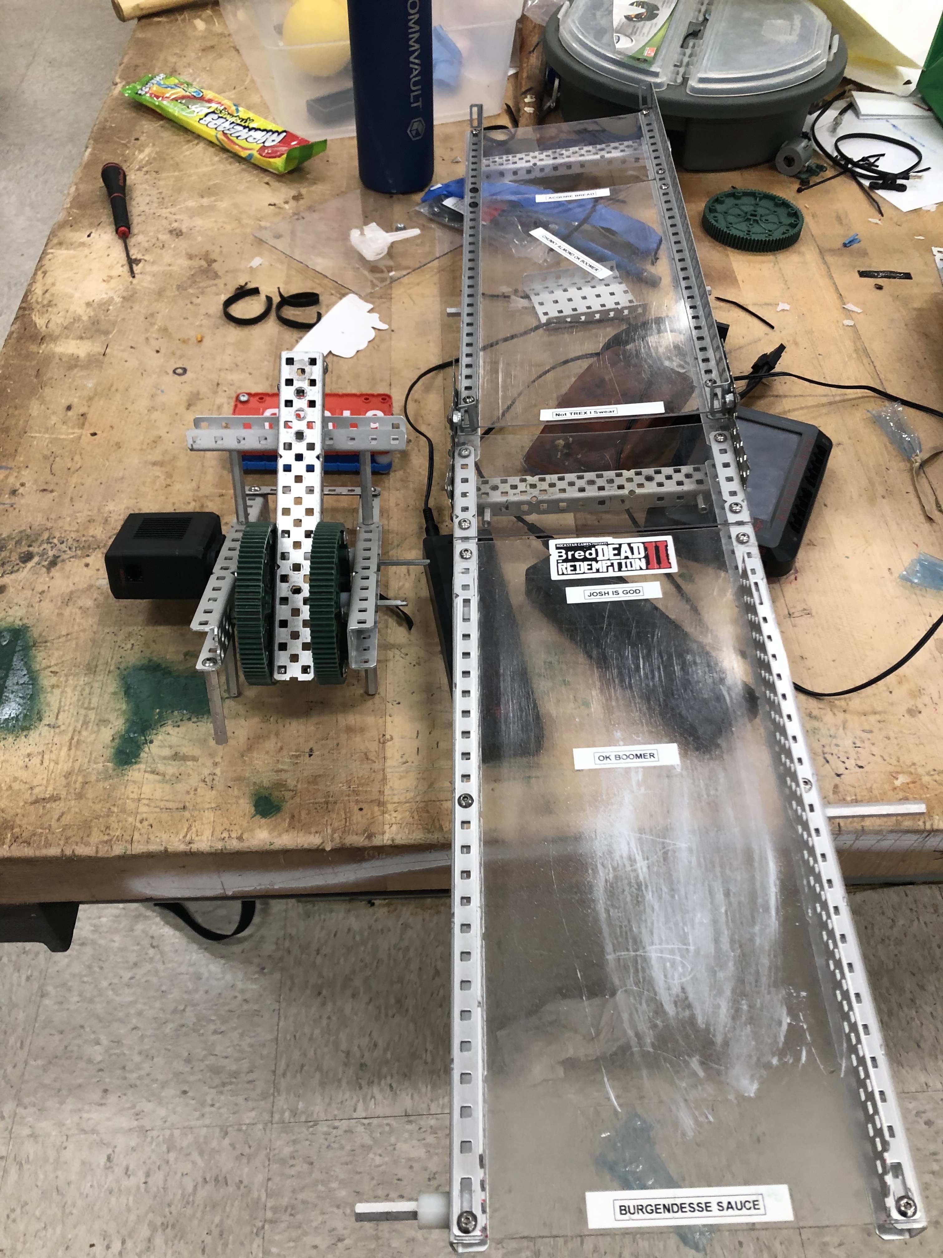

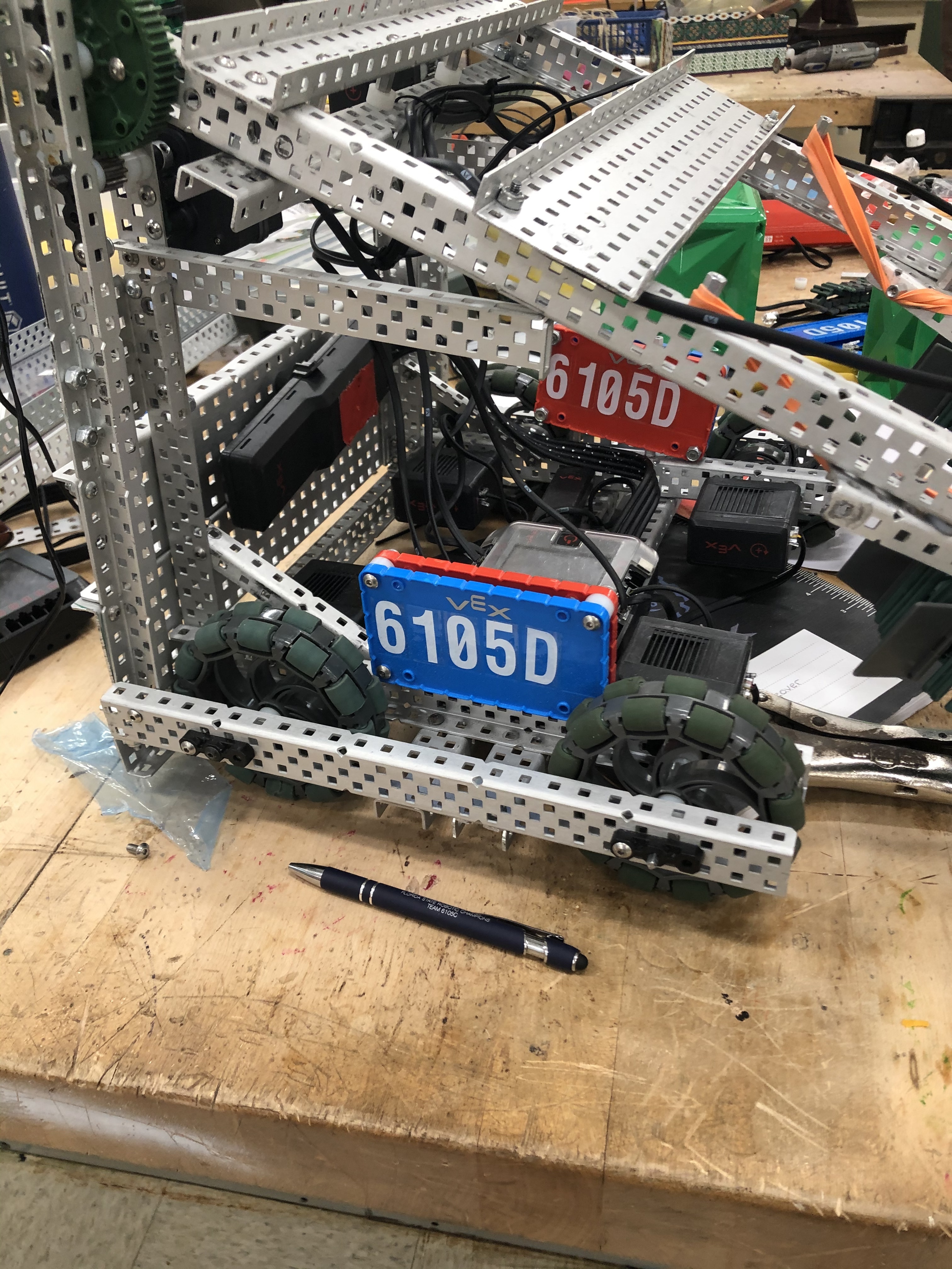

How would I assemble these together in the most efficient way possible?
Attach standoffs on the tilter mech to the crossbars on the base, so the tilter sits a bit higher than the motors. Remove the crossbar on the lift so you have room for a tray between the sides. Then use a hinge to attach the tray to the front, adding another cross bar as far up as you can. Attach tilting mech to tray. Pretty straightforward.
