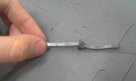

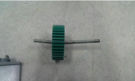

Weight would be an important factor this year. While doing some testing with our elevation, our team managed to bend all our shafts used in our elevation mechanism. They were mostly reduced to this state
https://drive.google.com/drive/u/0/folders/0B_yOY43_s-T6fi1NZGRESXQ2QXljMEtLN2hNeWMySFJXSEVLMDZ0cE0wUEFWb2ZCSTJGR3M
(I’ve attached the files if the link doesn’t work)
So if you were thinking when to invest in high strength shafts, I think the time is now.

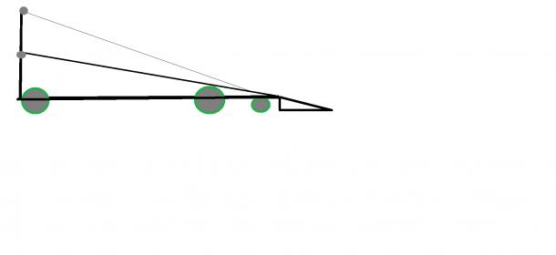

What my team has thought of for the issue of the other robot size is to max out our robot as close as possible to the 18x18x 18 box. This way our ramp is actually larger than 18" since it will start in the diagonal position. We would then just take a sheet of polycarbonate and put that on top with a possible winching that I am think about right now.
The trick will be to find a way to actually elevate the other team. I was thinking of possibly doing some sort of draw bridge design were the ramp is hooked up to HS shafts on one side then gearing another sort of winch with a form of string or small rope to the top of the tower the HS shafts would be on. I would then connect the other end of the string to the bottom of my ramp. The pulling of the string and resistance of the mounted HS shaft would then lift the ramp, possibly with the help of a linear motion kit for support.
I’ve attached a crude drawing of what I was thinking
[ATTACH]9492[/ATTACH]
Any comments or critiques on this design would be helpful as we have not done any tests on this design, its all theoretical.
I’m pretty sure i understand what you’re trying to do “MCE”. i think there is a youtube video of a team doing just that. my worry with that design is the motor devotion needed to effectively execute. How do you plan on confronting this?
I’m not quite sure I fully understand what you’re asking TheSheev. Are you asking were and how we would use our motors?
Yes, I agree with the Sheev when he says that it would take an awful amount of motor devotion to this. How do you plan on incorporating a ball launcher/intake mechansim with it? Remember you can only have 12 motors or 10 motors & pneumatics. Could you possible do this passively by say, bumping into a wall?
We would probably encompasses the intake and launching mech into the ramp itself. The launcher (flywheel) would be at the front of the ramp or below the front of it. The intake would be a convayor type system built into the center of the ramp. I don’t have access to my rough drawings as of right now so I’ll try to post them as soon as I can. The devotion of motors is in those drawings.
