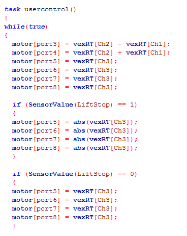

I am having trouble programming a limit switch for my NBN robot in ROBOTC. My robot’s main goal is the high lift. Because of the way I built my robot, when the lift is down I can still pull the lifter down which cause the frame to bend forward. This is my first year doing VEX and I am not very good at coding yet. My solution to this was to put a limit switch just under the ramp so when it is down, the switch is pressed. I have my 4 lifter motors coded to Channel 3 on the controller. The way my sister teams and I decided to code this was to try and code it so that when the switch is pressed, Channel 3 can only be + so the motors could only push up. This did not work as the motors could still be pulled down.

I tried using abs() but I can still pull the ramp further down. The picture is the updated code.

I am confused on the if statements, they seem to do absolutely nothing in your first picture and in your second picture, if the limit switch is pressed down and your ch3 is negative, the motors attached to ports 5,6,7, and 8 will go from negative 127 to positive 127. If the limit switch is not pushed down then your second if statement does nothing

So classic limit switch code may look like this. The idea is to limit the motors movement to one direction if the limit switch is activated.

My friend helped me format the code for my robot and the picture is the dummy code to get it to try to work. Unfortunately this code still does not work
#9
Perhaps the switch is broken, or the dgtl12 port on the cortex broken. Do you see the value changing in the sensors debug window? If not try another switch and/or port.
#10
I now know that I had the sensor in port SP in stead of port 12 because I could barely see my cortex.
Both of the codes work but, I decided to use jpearman’s code.
