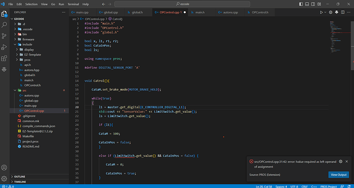

Hey there! I’ve been struggling to overcome this issue I’ve been having over the past few days, any help?
fix
CataInPos = false
(hint, you need comparison not assignment)

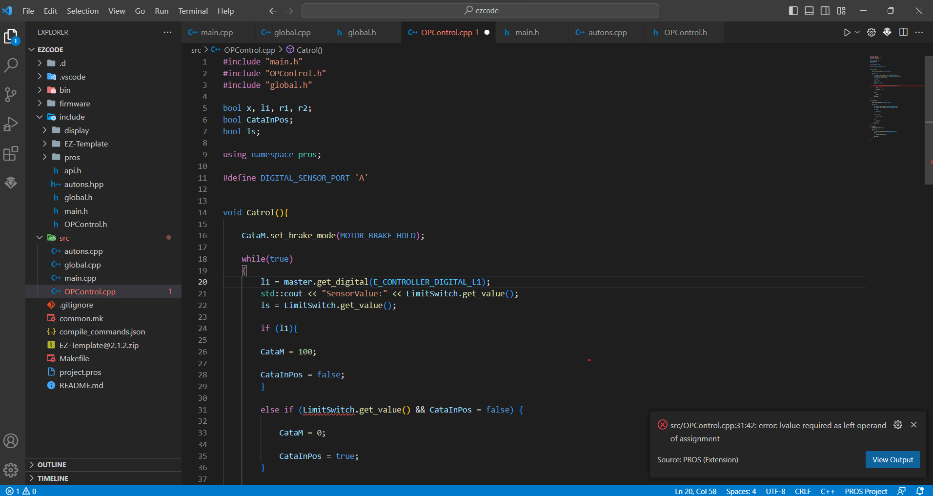

fix
CataInPos = false
