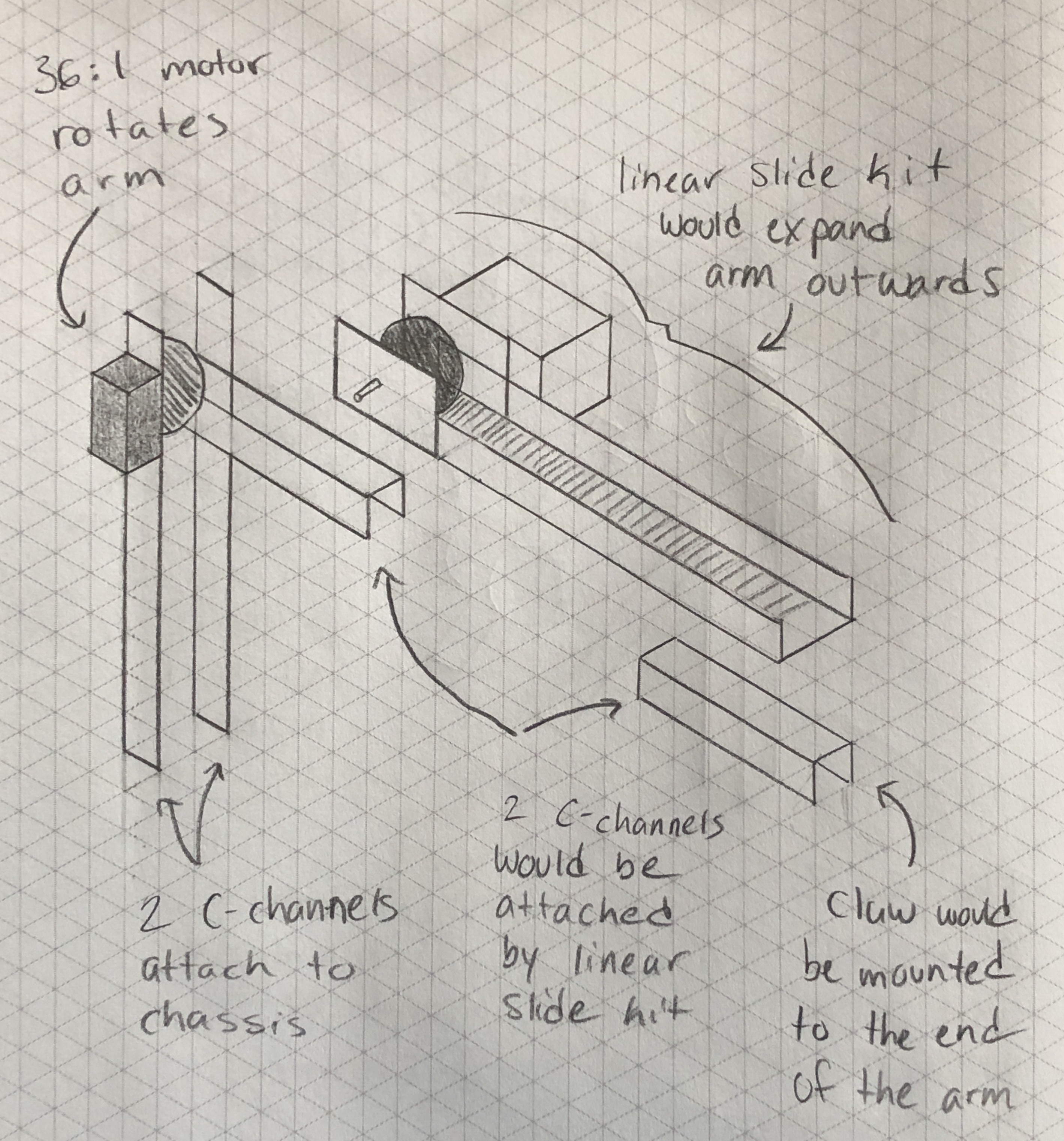

My team was thinking about attaching a linear slide lift onto a clawbot arm to provide extra reach in the upcoming competition. Only problem is, we don’t know how to go about it. Has anyone tried this before? Any advice on how to build it?
Make sure there are 2 points of support for the slider stages, otherwise things will bend. Everything else should be pretty self explanatory
