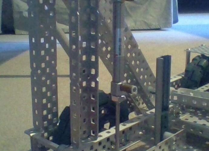

Currently, me and my team have designed a mobile goal intake that goes up and down using pistons and linear slides. For reference, our mobile goal intake is similar to 8059z’s mobile goal intake. Each side has a piston at the front of the L-channel, and the linear slide at the very back of the L-channel. However, after testing the double acting piston we noticed a problem. Because the piston only has one connection point to the L-channel it can often shift around, causing the L-channel to tilt forwards or backward. In addition, the linear slide has a lot of friction, which leads to changes of tilt in the L-channel with the piston being the pivot point instead of moving the whole L-channel up and down. We have already connected the L-channel to the “sliding thingy”? using two connection points, but it still allows for a small amount of tilt.
What might be the best solution to this problem?
Thanks!

@nbennett In response to step 3, currently the piston itself isn’t moving around as much as the connection point between the piston and the L-channel.
It is actually hard to visualise how your mounting looks like.
A pic will do wonder :slight_smile:
@meng here it is, where the piston is attached to the L-channel is where it shifts around because of the friction caused by the linear slide.
think the main issue is the mount of the piston and linear slide is too far apart.
The force from the piston is not just pulling the linear slide up, but it is also producing a turning effect on it (unless the slider is able to moving up and down with no friction).
And when the linear slide is not moving vertically, it will cause the plastic slider to tilt and rub against the sides, resulting in even more friction.
And of course the position of the linear slide at the back of the L-bar might be a problem too… especially when the mobile goal is loaded. Since the CG of the mobile goal is not in-line with the linear side, it will cause the L-bar to tilt (again… turning effect).

CG = centre of gravity… which for most symmetrical objects, we can assume it is acting from the centre of the object.
This means the weight of the mobile goal is pulling it downward from the centre of the goal. And since the pivot (i.e. the linear slide mounting) is not in-line with this weight that is acting downward, it will result in the weight causing the entire mount to tilt forward, and hence resulting in even more friction on the slider.
Hint: there are reasons why 8059z choose this particular position of the mounting of the linear slide and also the way they powered up the linear slide as well :slight_smile:
I see… so by moving the piston and linear slide not only closer to each other, but to where the CG of the mobile goal would result in less tilt, correct?
That will be ideal.
But of course, the next question is - how to squeeze everything into this confined space :stuck_out_tongue:
